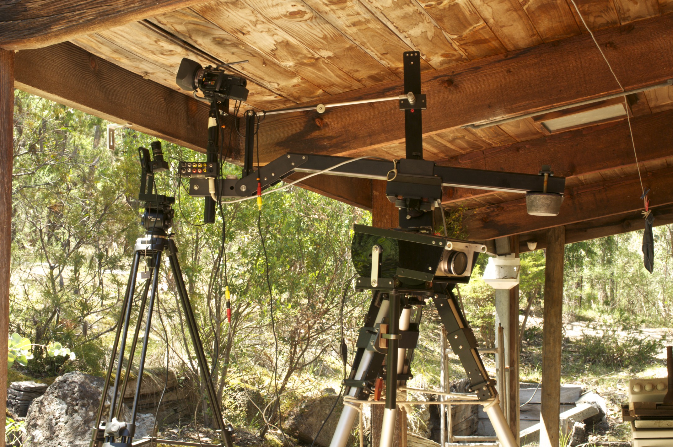

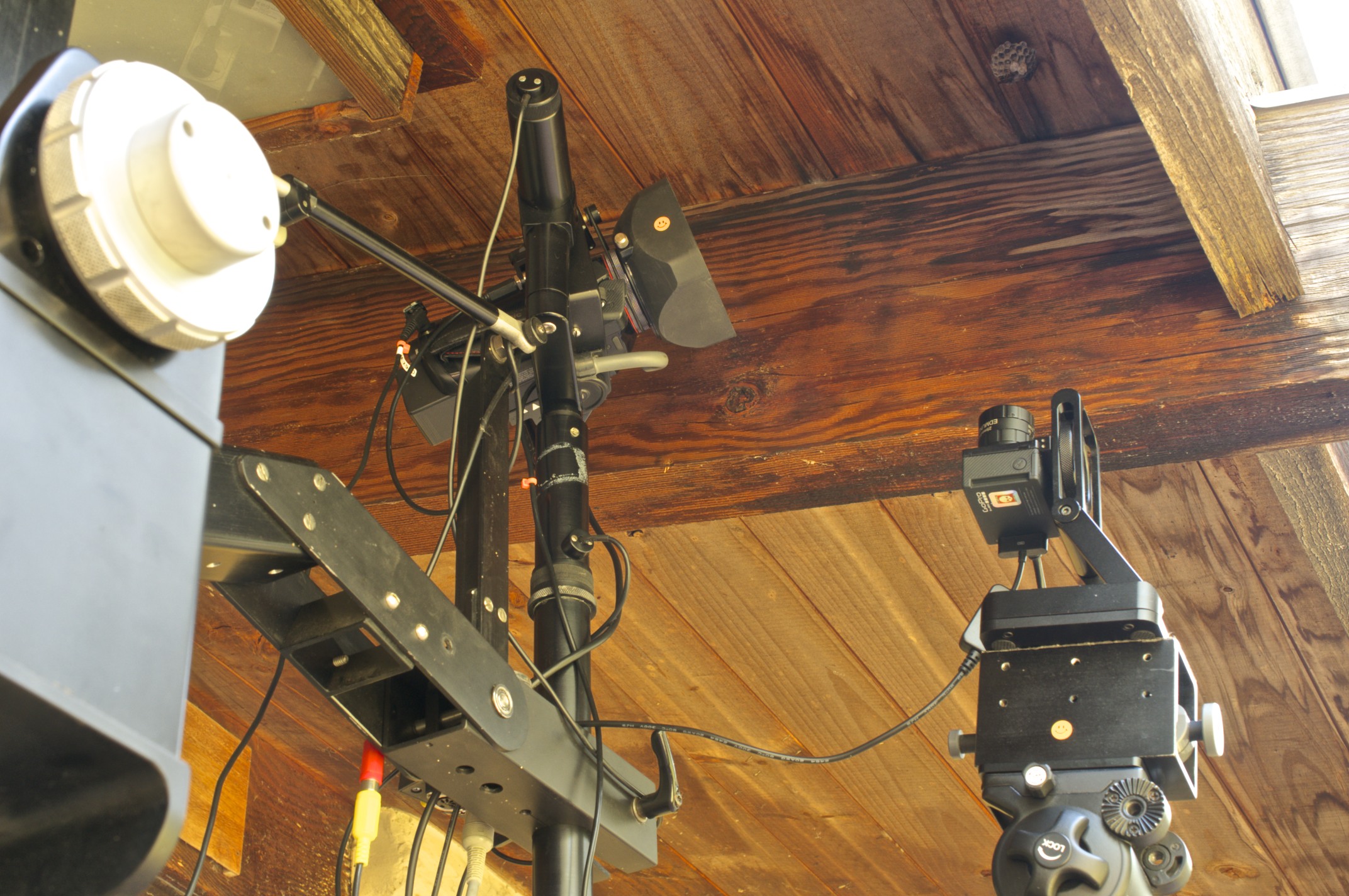

Below are two pictures of my current paper wasp set up. The larger camera is a TM 900 mounted on a remotely controlled head. To make sure the Infrared signal from the remote make the distance I use an infrared extender that positions an infrared emitting diode at the front of the camera. For reasons I do not understand the TM 900 and HC 900 do very well under these conditions – far better than my Sony EX3.
The other camera pictured is a GoPro with a ‘C’ mount conversion. It also has a removable infrared cut filter making infrared work possible.
