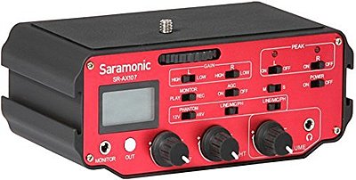

I think I have the answer regarding mixers ...the saramonic units from China make some really nice adapters which have XLR inputs on unit level controls with peaking lights plus a headphone amp all built in!

Posts: 8,441
Re: FZ1000 audio channels
The Tascam is really nice I must admit but I'm getting a Saramonic SRAX107 .. it has XLR and Phantom power plus visual level meters and peaking lights and a headphone output and mounts under the camera so that will suffice for now ..I just need to be able to have accurate input levels and for $149 on special it's worth a try! It was $229 so a lot cheaper than the Beachtek .. If I was up to spend nearly $400 then the Tascam DR60 would be awesome but that's half the price of the camera.
I'll give you my opinion (good or bad) once I try it out!!
