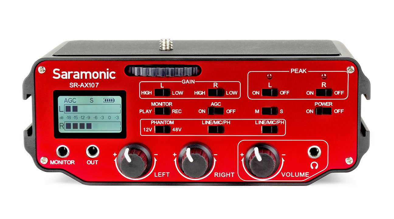

Re: Ninja 2 with FZ1000
Hi Mark
First of all I have one more issue! I don't seem to be able to get anything out from the HDMI passthru socket so it feeds my Encoder ..which says "no HDMI input" ... Is there anything one needs to setup to get this working or is causing the output to be blocked? Have you used the HDMI out? I'm wondering if it is active in standby mode or do you have to be recording?? Any bright ideas from you or Jack??? It's my last obstacle!!!
OK after trying a whole bunch of XLR adapters I found the Saramonic AX107 to be perfect!! it sits between the tripod and camera and has tons of features too... really worth looking at and half the price of the Beachtek units ! Under $200 and awesome controls including headphone amp, phantom power and dual input levels (0 and +20db) as well as line inputs and neat level peaking leds and a nice LCD display too!!
