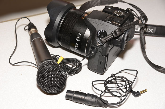

SM58 does not use phantom power, BTW. I have used a similar cable to the one described previously on my FZ1000 with an XLR mike similar to the SM58 successfully. While there are xlr to mini plug adapters available, they will put a lot of strain and leverage on your mike terminal; a cable with a small plug would be a lot safer, I think. I purchased several of these cables (some time ago, but they are still there) from this company: https://www.soundprofessionals.com/c...P-XLRF3-MINI-1
and have been very satisfied with them. Cables of many types made to order as to length, type of plug, etc. You would want an xlr to mono device with a stereo miniplug (careful, I once bought one set up as stereo to a stereo plug and the two signals cancelled out!)
This said, the dynamic mikes like the SM85 have a relatively low signal output. You will probably have better results with a condenser mike using an internal battery, such as the Audio-Technica ATM33a (Cardioid) or ATM10a (omni) mikes, which, while designed for phantom power, run happily on an internal AA battery and in my experience have an excellent signal level for the Lumix. Or, for that matter, take a look at Sony's ECM-AW4 bluetooth wireless mikes, which work very well at a very reasonable price (much to my surprise; I picked up a set for my Tascam just for fun and was well pleased with how they work.)
