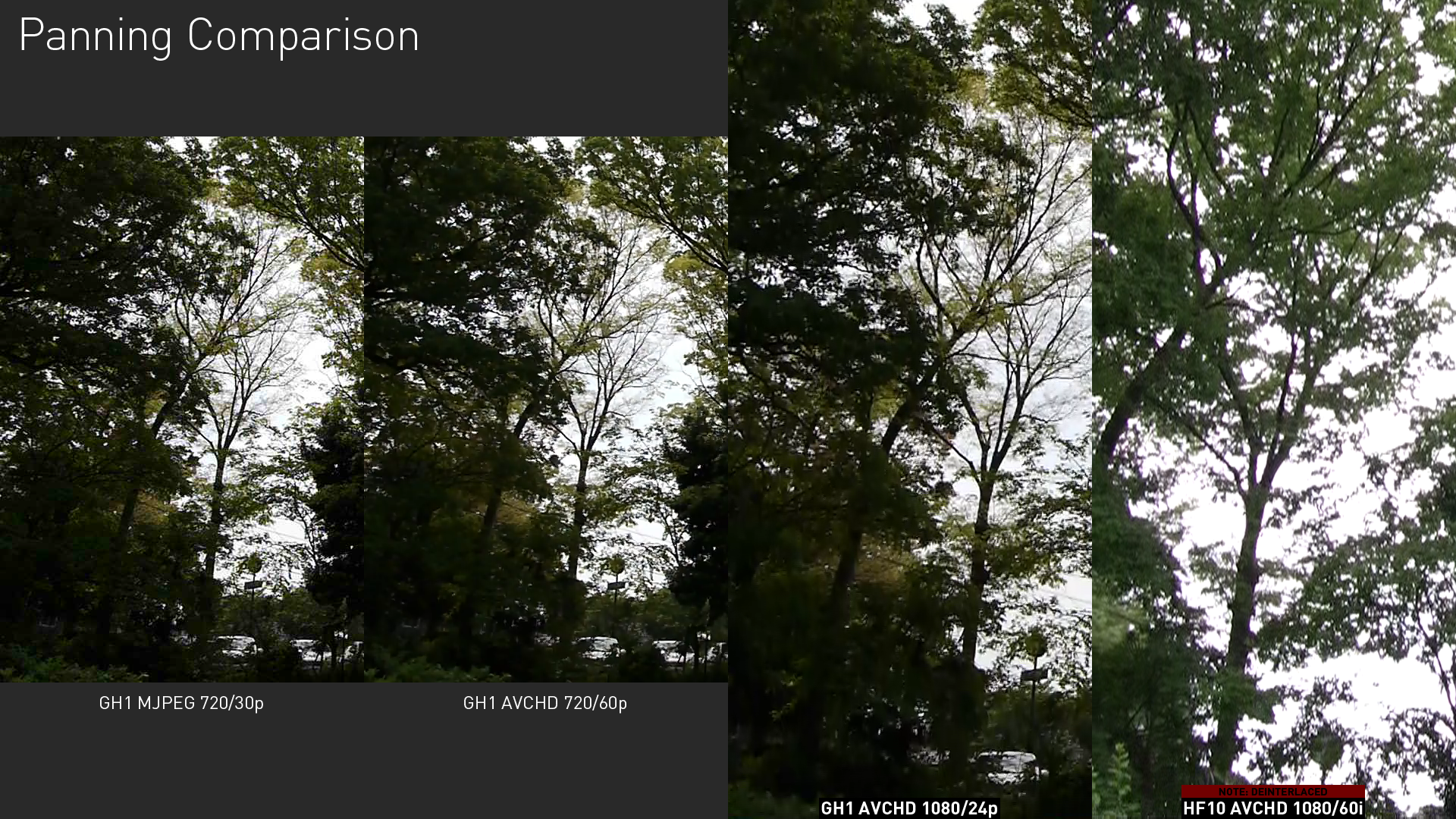

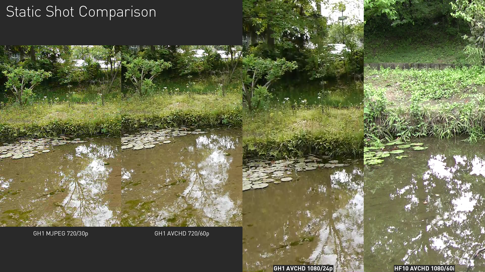

I did some comparisons of the different video modes on the GH1 using the footage from Watch Impress. I also threw in the HF10 footage that was linked here. It's not exactly the same shot, but it makes for an interesting comparison.
Edit: you're right Paulo, I was thinking of the HF11. The HF10 is 17mbps AVCHD only.
hahaha, I was just in the process of exporting series of frames via TMPG when I read your post. Could have saved myself the effort, your comparison is very well composed and highlights the essentials.
It seems that the codec is set to save bandwidth on the darkest areas of the frame. Movement seems to be a lesser factor (check the "green-soup" in the foliage both on movement and static).
Maybe we have to change our workflow a bit to adjust. On film, it is common to slightly overexpose, with small video sensors, overexposure had to be avoided. Phil Bloom faced problems trying to lift exposure in the Zeiss lens clips but grading went well for the Hawai sunset clips (in that case it looks like he brought exposure down). The skies on the GH1 don't overexpose too quickly, it seems. Bring on the light.
In short, it is a disappointment but the workarounds may be a lot easier than setting shutter speed on a 5D2 ;)
