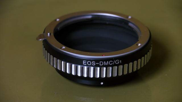

Here is a shot of the Canon EF to M4/3 adapter.

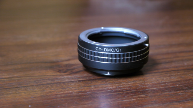

Contax C/Y mount to M4/3.

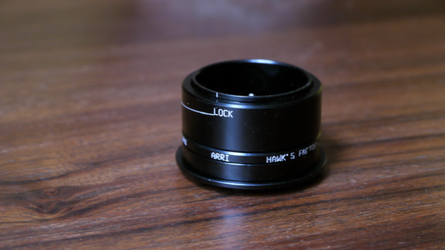

ARRI Standard to M4/3 mount.
