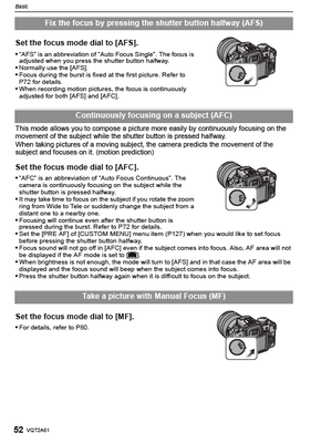

I didn't think iA mode had anything to do with it. I thought this had everything to do with the AFS vs AFC setting.
Regarding video, something I wish is that AFS worked in video mode. Instead, I have to physically rotate the focus mode dial to MF to stop autofocus. And it would be nice to just half-press the shutter button to have it focus real quick, then go back to manual. AFS does this for photos, but not video.
Page 52 in the manual.
