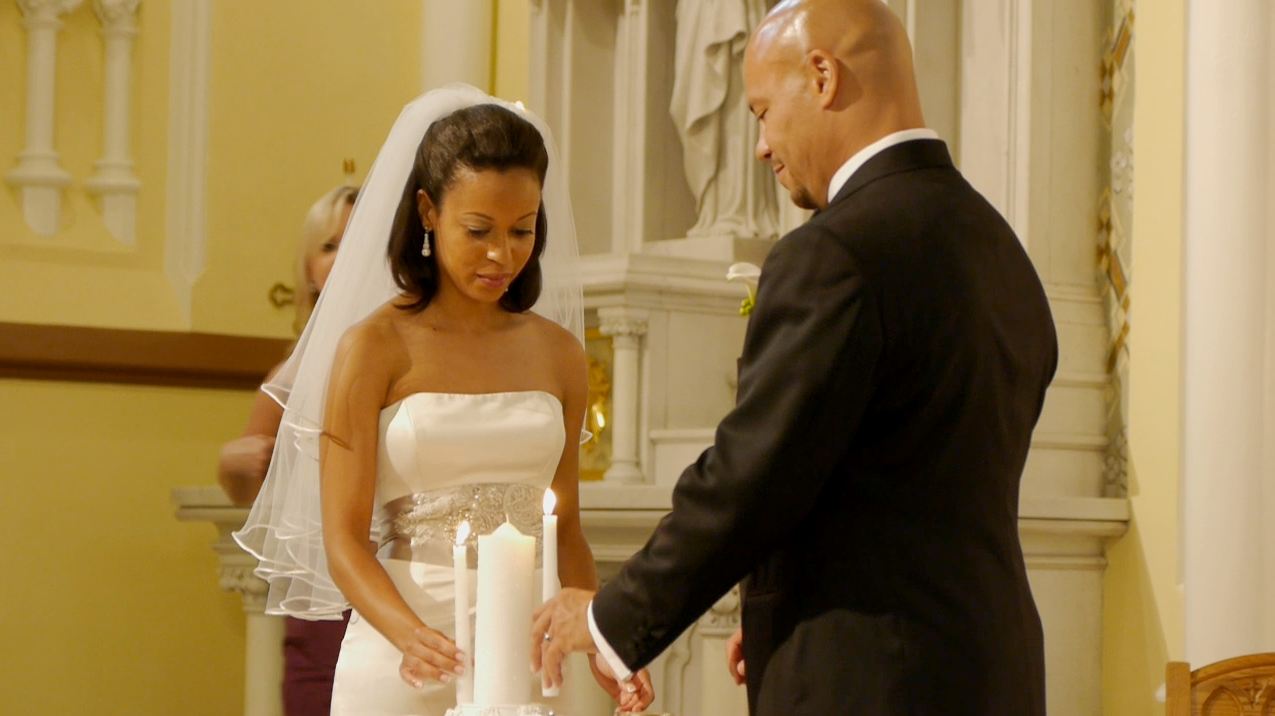

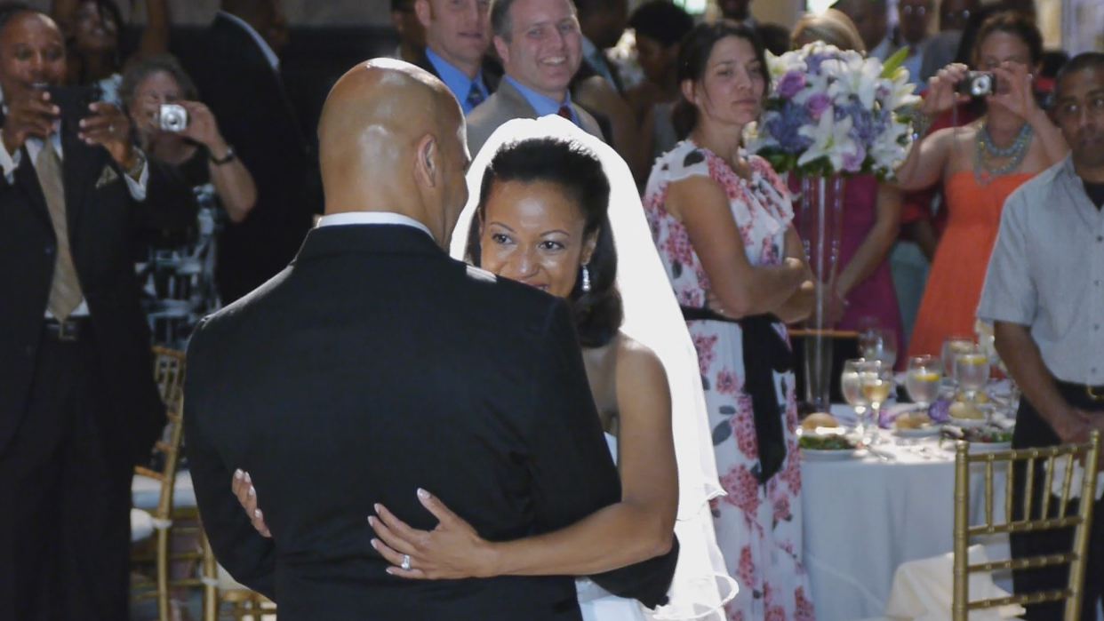

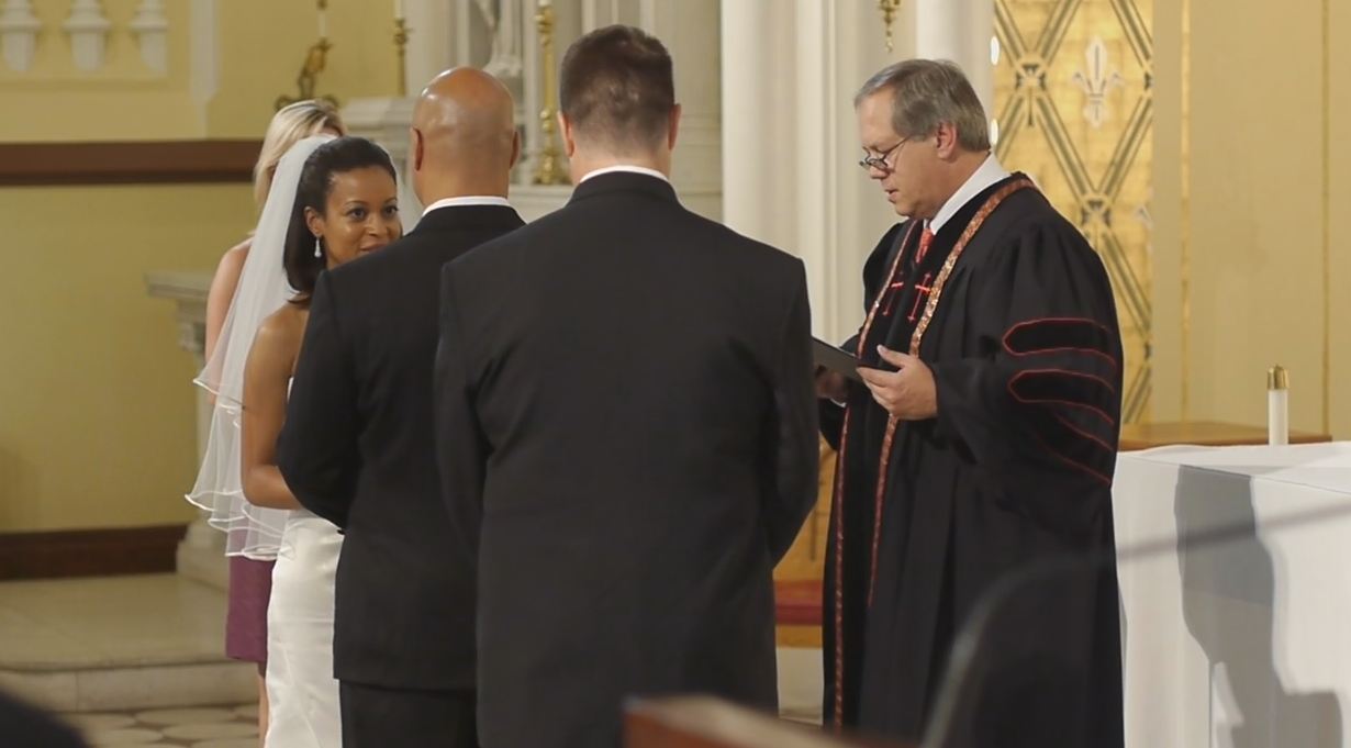

Here are screen grabs from wedding Saturday taken with a Canon 50mm F/1.4, a Tamron 28-70 F/2.8, and a Sigma 18-55/F/2.8.
Admittedly the conditions were pretty good, and not as dark as we may often enounter. The screen grabs are washed out, and the actual video has more contrast, but you get the idea.
Anyone filming weddings with a GH1-canon50mm-f-1.4.jpg   Anyone filming weddings with a GH1-tamron.jpg
