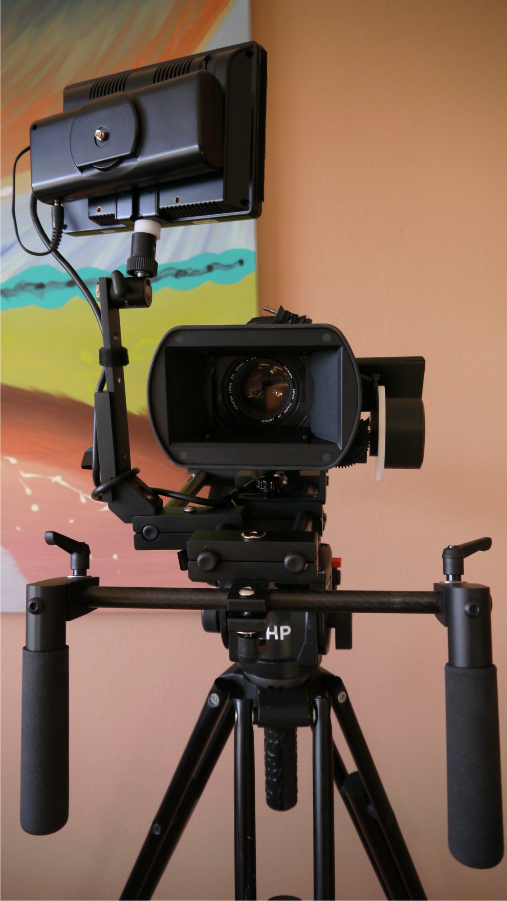

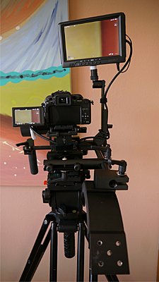

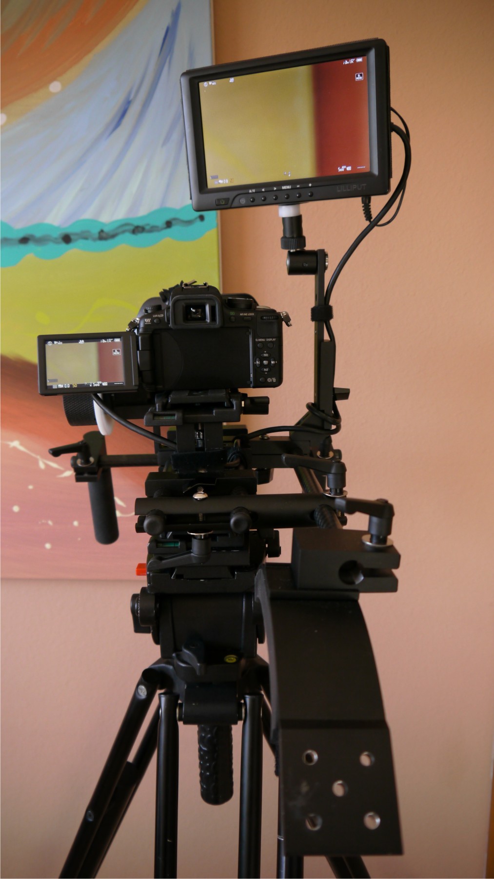

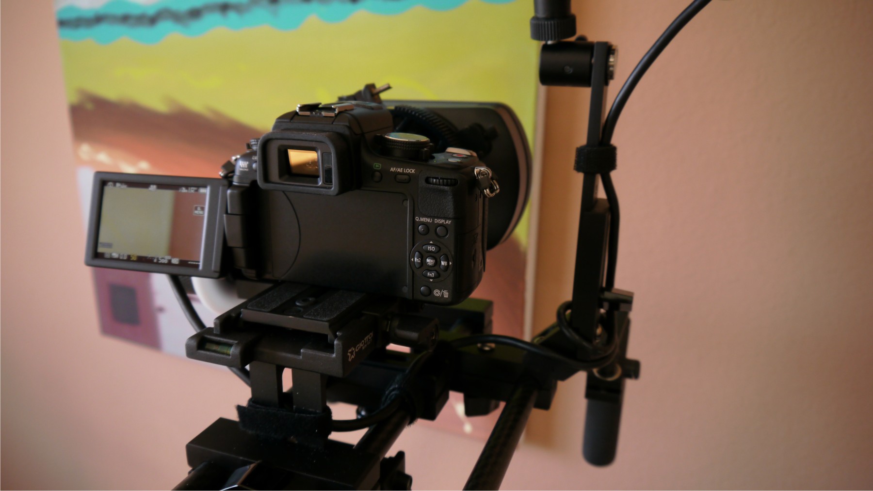

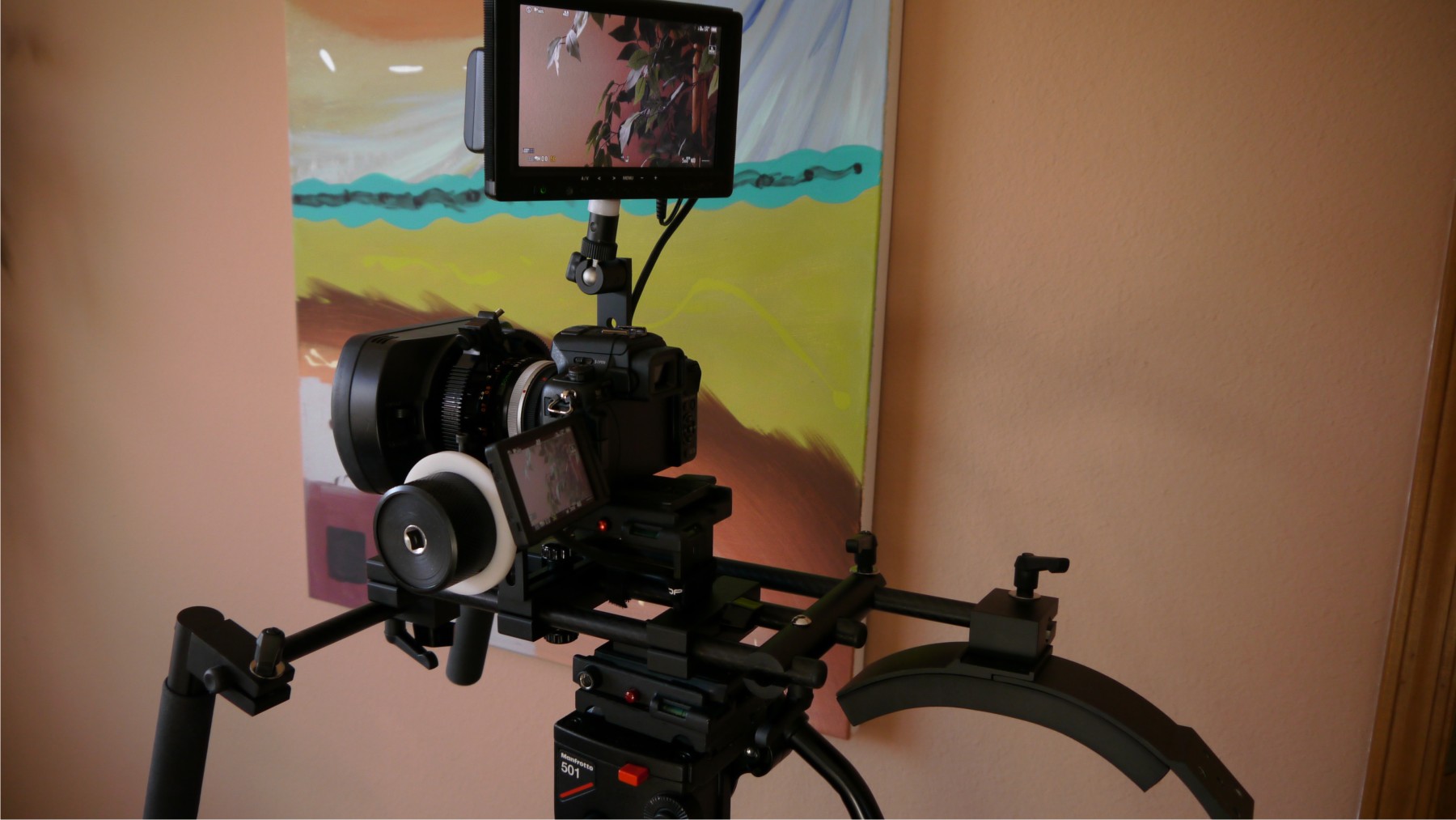

This is my version of the Bulldog shoulder rig that I use to film parts of our The Santa Fe TV Show.
The display is in a comfortable position, and the rig feels very solid and it is very well balanced even without weights in the back. The GH2 mounts a 50mmCanon FD lens and I used the lens shade from one of our EX1s attached to a 77mm step up adaptor. No vignetting at 14mm.
The HDMI output of the GH2 is GREAT, it fills the 16:9 screen from side to side and I can read all info!

Do you mount an audio recorder on there or do you have a body pack or something?

It depends on the size of your audio recorder, but my Marantz 661 would fit mounted on the side bar (the one where the monitor is attached to. Remember. that vertical bar is adjustable up and down a good 2", with standard 1/4 holes in it where you can mount extra stuff. Very nice design...
