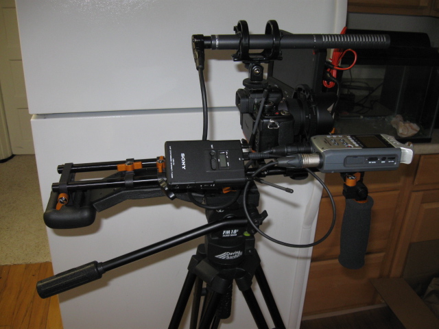

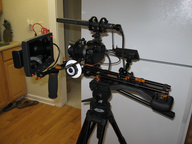

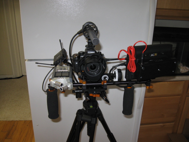

I ordered the newly updated Straight Rig from Jag35, and couldn't be happier. The rig feels great, is solidly built, and they shipped it in record time for $20. I ordered an extra single rod clamp for the Zoom and an articulating arm for the wireless receiver, which mounted to the cheese plate shoulder pad. I thought about getting the monitor seperately, but by going through Jag35 you get a tripod plate, rod clamp, hdmi cable, battery, and power cable all included, which actually comes out cheaper. Now I'm waiting for Jag to release the anticipated D|Matte matte box to finish off the rig.

Very nice! Have any idea how much it weighs? Lots of discussion of tripods not having low enough minimum payload for the gh2, but maybe by the time a lot of us pile on all our goodies it's a moot point.

not sure of the weight, but it's definitely weighty. heavier than my XHA1. A couple things I don't like. I can't access the battery compartment without taking the camera off the stand, which is a pain. Also, when panning the display on the monitor isn't smooth like in the lcd of the camera. Also, when I push record, all the screen data disappears on the external monitor, but it's still on the camera's lcd. I hope Panasonic updates the firmware to not do that.

What mic is that,i take it you have to use an adaptor,i cant find one of these Hosa Technology GMP-467 - Right Angle Adapter GMP-467 B&H Photo and the adaptor i use with a small lead has been giving me a few problems ie the camera loses sound at times.

Hey, Martyn, it's a Rode NTG-2, and it's plugged into the Zoom H4N, not the GH2. I sync in post. The NTG-2 takes a battery so that I don't have to use the Zoom's phantom power, which drains the battery of the unit faster.

No one is asking the important question - is this balanced? It really looks impossible to achieve with all the stuff strapped on. Not trying to be negative. I see a lot of rigs like this and tried it myself and after 2 minutes I gave up. The front is just too heavy.
I filmed a few weeks ago with my shoulder rig. This was in China and was an all day shoot and this got very tiresome by late afternoon and I had the shoulder rig as light as I could go - no mattebox, no audio recording. I did use a follow focus, but even now I tend to take this off for 'all-day' on the go shoots. I go to remote locations and I am loathe to travel with balance weights so I keep the front of the rig as light as I can. A shoulder rig should float with little feeling of heaviness in the support hands.
Now I do record audio by myself sometimes and put my Tascam recorder and lav in my photo-jacket pockets or use a small bag with straps.
