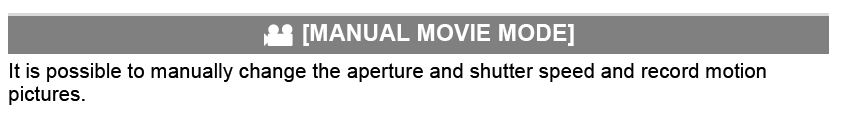

Jim, as Waldi has told me, the M mode with the GH2 is not true Manual. You need the Manual Movie mode, is that what you are using?
