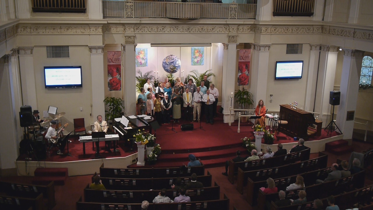

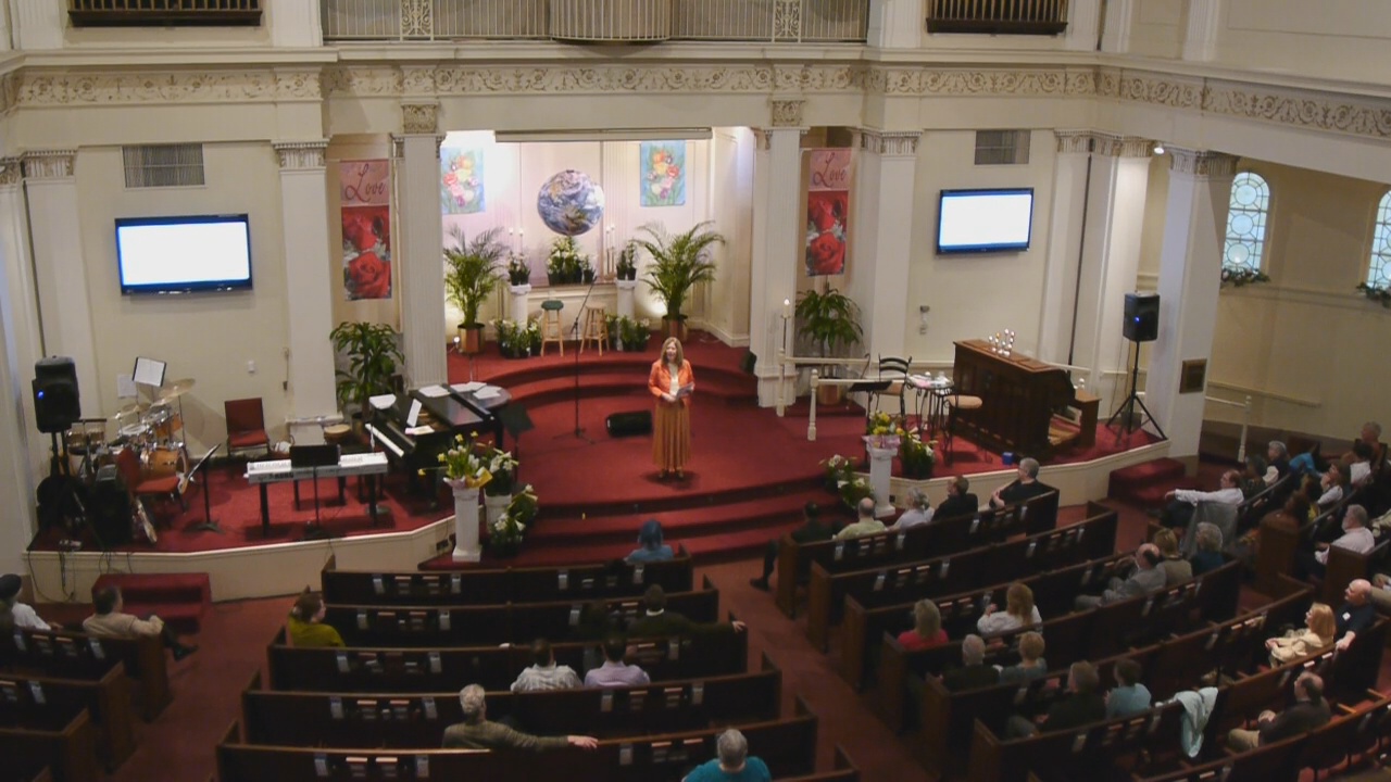

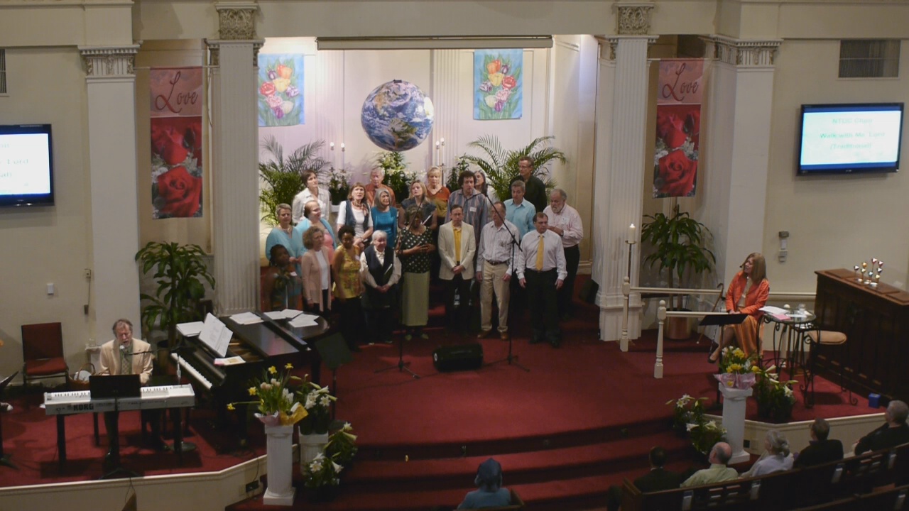

Any thoughts? Here are some shots using auto iso on three different lenses, exposure wide open, and what I find surprising is how much darker on the edges the image from the 20mm is. The 18-55 is actually better exposed overall. Maybe because it is widest, and has more scenery from which to calibrate the ISO settings.
From left to right 20mm, 30mm f/1.7, and bottom left is 18-55mm 2.8 lenses.
