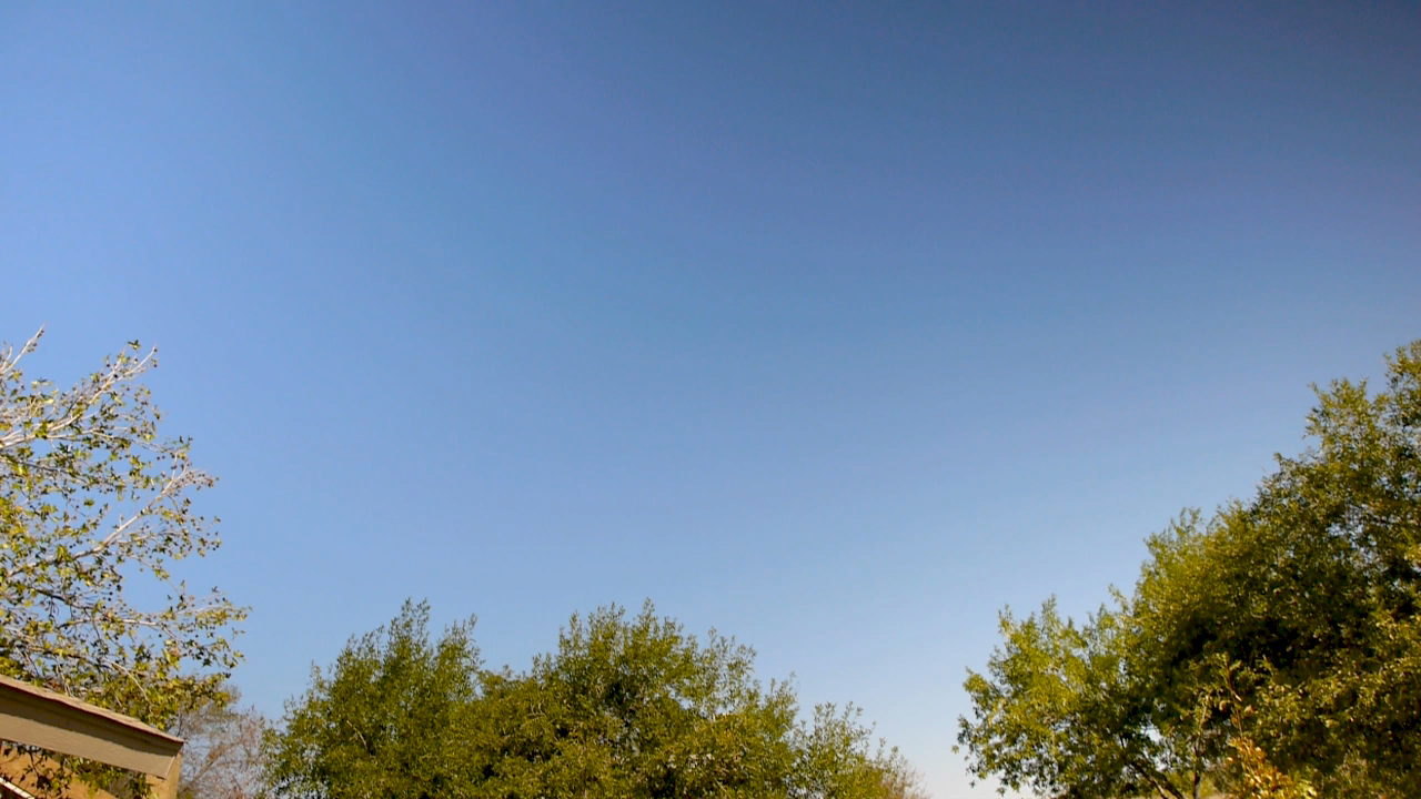

I have been trying some variable ND filters with my GH2 and have found a strange issue when filming outdoors. When there is sky in the frame I see horrible banding. This happens at all angles related to the sun and is not really present when shooting stills. I can't really see the effect anywhere but when sky is present.
So I wanted to ask: Have you seen this? Or could you test with your filters to see if this happens?
I want to go with the variable because it is so flexible, but it looks like a topographical map wherever there is sky.
Thanks for your help!

I'm guessing it has to do with the model of filter and you might need to find a different one. I've read of some older/less expensive filters that are prone to banding.

I'm respectfully skeptical... If it's solely the fault of a cheap filter, then why, as the original post mentions, doesn't the problem manifest in still photos?
I'm more inclined to blame the codec. AVCHD (like many forms of compression) looks for was to ditch detail in areas the eyes aren't inclined to notice in a moving image. This often leads to dismissing information from graduated colors, such as a sky that ranges from light to dark, in favor of detailed/contrasting information, such as leafy trees, anything with an edge.
The reason you may not see this without the ND filter is that your sky is near the maximum exposure and actually lacking in graduation of lightness or color. Introducing the filter introduces the variation, and the codec degrades that a bit too much.

Thanks for your input guys. I am just looking for a workable solution. So far i have tried a $70 vari ND and now this one ($200). Both show the same behavior. So I am looking for a GH2 user who HAS found a variND solution that does work.
I too think it has something to do with the codec or the way the chip gets a video image from a higher resolution imager.
Either way, I don't want the banding in my footage. So if anybody with a GH2 has a variND that can be used outisde pointed at the sky in video mode at wide aperatures I would love to hear from you.

I get noticeable banding on the beautiful deep blue Californian skies around here and out in the Valley and desert with my GH2 with or without filters, which is depressing. It's not always particularly bad (a lot of people don't notice it), but it gets somewhat worse when using a polariser. So I suspect the codec really doesn't do nice skies justice -- and that changing the filter will have some impact, but not a lot.

When making ramps or gradients in After Effects they look smooth in the program because it's not compressed, but when I export to ProRes422 the files generally show banding because information is lost(to get around this I usually add noise to the image)
Variable ND filters are just two circular polarizers.
If you use a regular polarizer and make the effect as strong as possible and shot up towards the sky you may notice certain parts of the sky are much darker than usual and other parts of the sky have very little effect....you could say the sky has more of a "ramp" or "gradient" than usual when using a polarizer.
From my explanation in the first paragraph certain types of compression will exhibit banding in gradients....I assume because they can't display all the levels of brightness and color we can see....and when you use your variable ND filter you have really just attached two polarizers to the front of your camera which can change how the sky looks.
An interesting experiment(which you probably don't want to take the time and try) would be to hack your GH2 so that the noise pattern is very visible(not like with the stock bit rate which is lower and "smooths" the noise out) then shoot at a high ISO and see if the sky still shows banding. I would think the banding would be reduced since this would be similar to adding noise in After Effects.
Hopefully I didn't put out any false information in this post....mostly just ideas.
