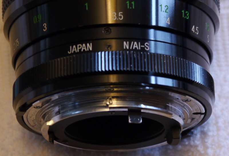

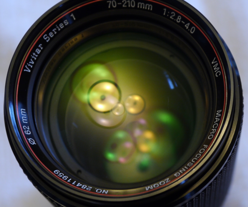

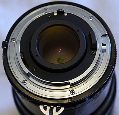

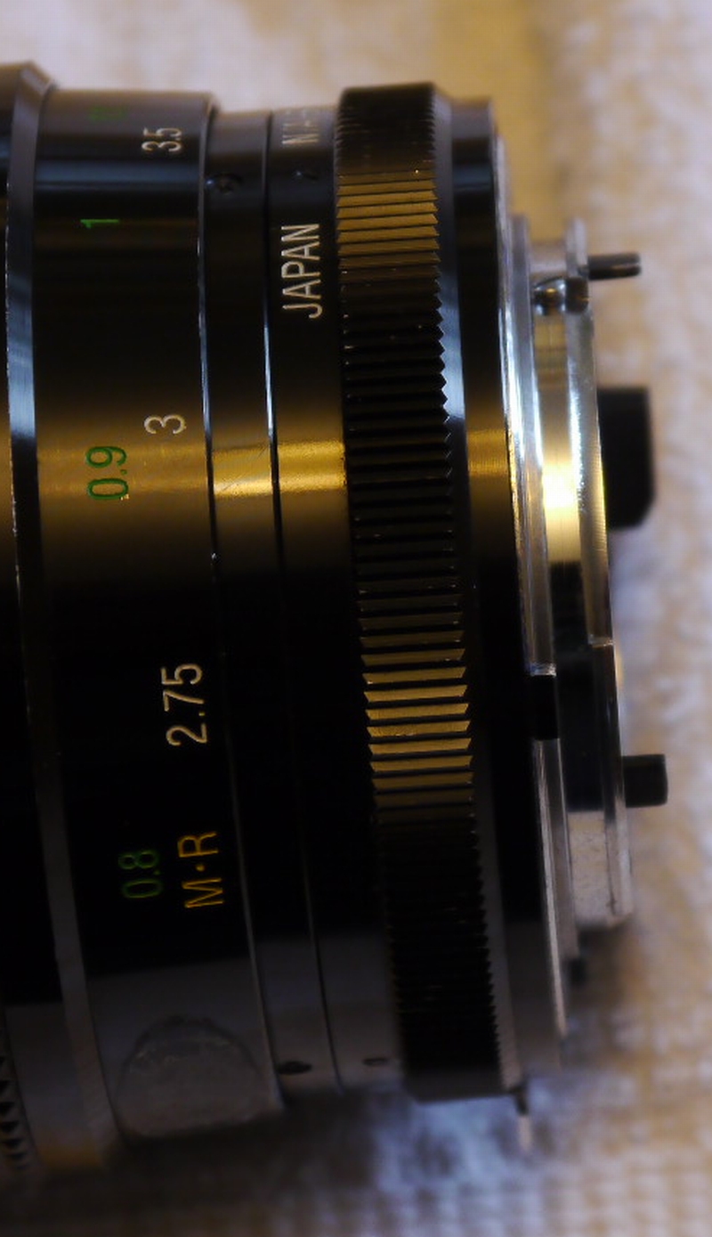

OK, here are a few pics of this lens. Any help in which adapter I need would be most welcome. BTW, you can see the "N/AI-S" stamped on the bottom rear of the lens. Is that any clue as to the type of mount? I'm just not familiar with Nikons.

You know, I FINALLY read the first thread completely and clicked on the link to the adapter you bought.
The problem is not on the lens end (I assume it attaches?), but on the camera end - your adapter is for Nikon to 4/3, not Micro 4/3.
Since your lens has an iris ring, you'll probably want this adapter:
Fotodiox Professional Photography Supplies and Equipment
That's my best guess, at least.
