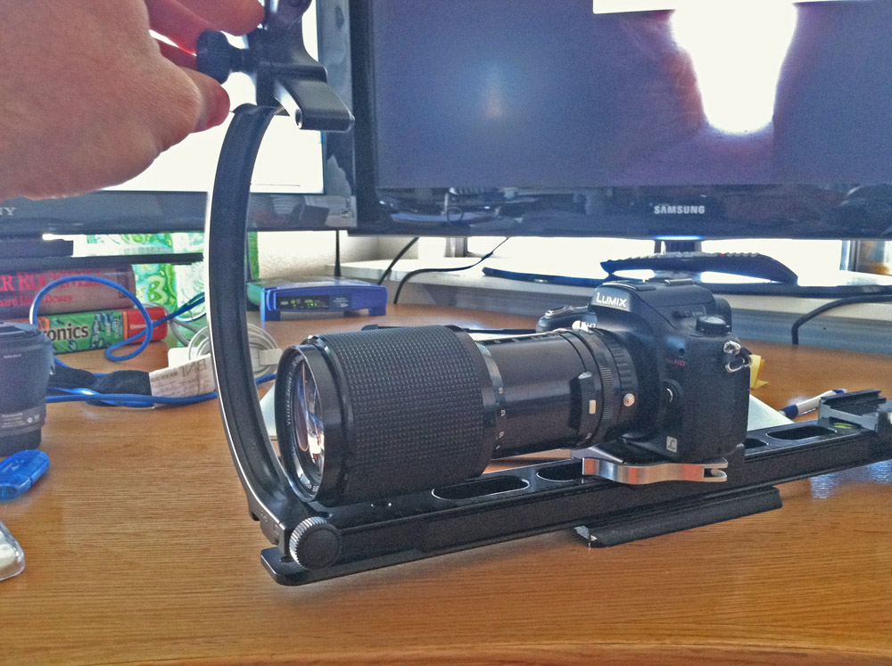

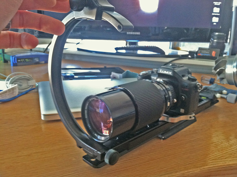

I have the same lens, camera, etc. Since nearly every surface part of this lens has to twist or slide or both, it's difficult to support it without restricting some option or another. My Fotodiox adapter is a touch loose as well, which aggravates the situation even more. I'm using the cobbled together solution in these photos. It's a Really Right Stuff 18" bar with one of their flash brackets under the front 1/4" of the lens (it twists, but only moves back and forth slightly enough that there's no functional interference with the lenses performance). The height of the flash bracket's base is just perfect to provide a little tension against the lens and keep it feeling tight. Your mileage may vary, but I've shot some with it and haven't been terribly displeased. One advantage is, that I have a spot to mount a microphone or another accessory on top of the flash bracket, and the circular part acts as a second "handle." Not too shabby. :)
How To Support Heavy Lens-lenssupport01.jpg   How To Support Heavy Lens-lenssupport02.jpg
