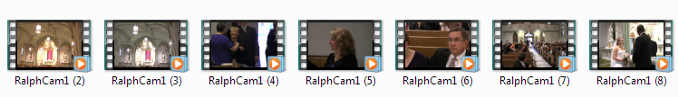

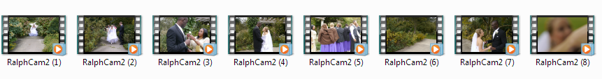

If you're shooting multicamera, then batch rename your files as I've shown below, that is very easy to do. Takes seconds to do, if don't know how let me know.
Shooting with 2 GH2 bodies - Timecode / Sorting Options-capture.png   Shooting with 2 GH2 bodies - Timecode / Sorting Options-capture-2.png

Your key is your workflow during the shoot. That keeps it simple and makes your issue a non-issue. Yesterday I shot with four cams, and I just changed lenses as needed for 8 hours of run and gun. If I had just picked up another camera instead of changing lenses, it would be a nightmare today. Instead I download my footage and batch rename it according to camera #, and everything is self explanatory, very simple. I drag it on the timeline, sycnc it up, and I begin editing within a few minutes, no need to sort through anything.
