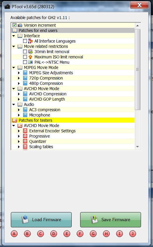

There is one thing I don't think any of us have posted though and that's the difference between the hack itself and the patches/settings being written for it.
The hack will load the stock firmware but you can change certain things like recording limits, etc...again with the regular firmware.
