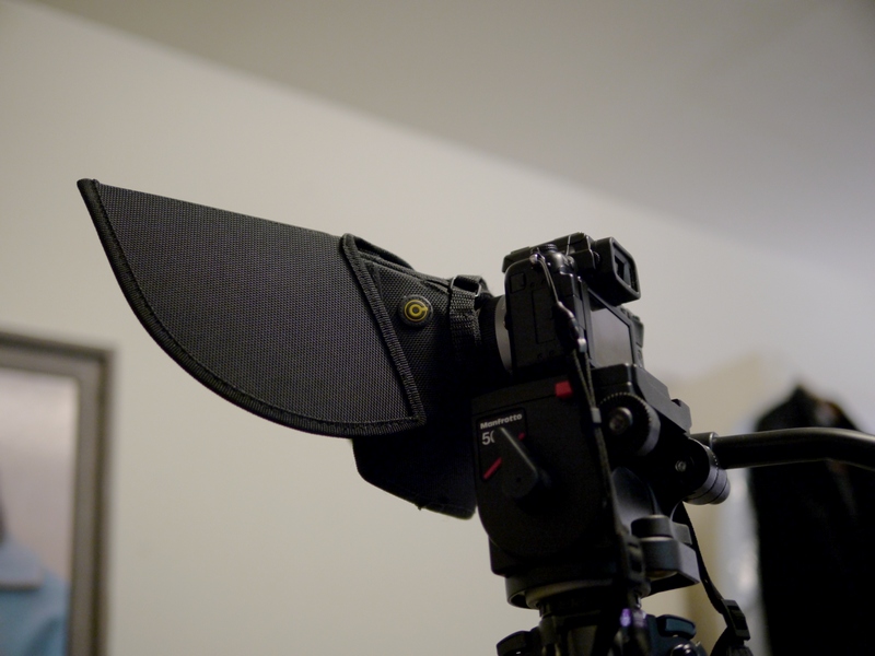

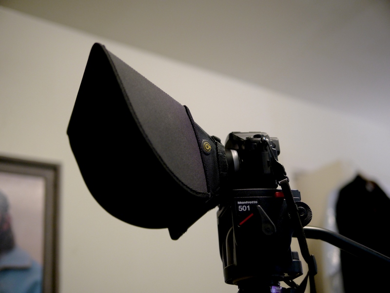

Since I use Panasonic Lumix lenses, the Pan/Leica 25mm f1.4, and the Oly 45mm f1.8; I use 46-52mm stepup rings on the Lumix "pancakes" and the Pan/Leica 25mm, a 37-52mm stepup ring on the Oly 45mm and get my filters in 52mm size. The Lumix 45-200 and the 14-42mm "kit" lens both have 52mm filter threads so the one size, 52mm, fits all of my lenses.
One thing very important when using filters on these lenses is to insure you have adequate "shading" from stray light with a decently "deep" lens hood. The 45-200, 14-42mm "kit" lens, and the Pan Leica 25mm come with workable effective hoods, but the 14mm and 20mm are problematic. The 20mm is wide enough that standard hoods vignette, and the only hood I've seen that doesn't vignette on the 14mm f2.5 is "pathetic" for effective shading.
My solution for the 20mm is the CineTactics MatteBlox DV with the oversize French Flag (cinetactics Home Page). It's "HUGE" but works and it should also work with the 14mm (I haven't had a chance to test it yet with the 14). Two images attached showing it on the Lumix 20mm.
Thread: Infinite focus - explaination and options-cinetactics_mattebloxdv-1-.jpg   Thread: Infinite focus - explaination and options-cinetactics_mattebloxdv-2-.jpg
