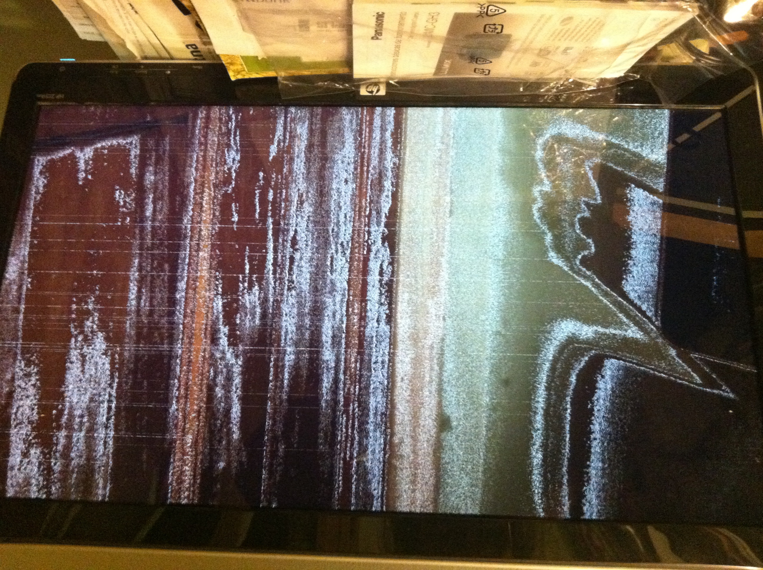

The first accessory I tested was the HDMI out and that seems to be wonky at best. My BlackMagic UltraStudio Mini Recorder didn't recognize the HDMI output of the camera and my Lilliput LCD monitor which works fine with the GH2 put up an "Unsupported format" message. Nothing I did in the GH3 menus changed anything. Finally I attached the HDMI cable to my Samsung LCD set. That worked but there were odd sparkles in the image that corresponded to areas of the image so if I moved the camera, the sparkles followed the image. Very odd. I recorded at the same time I was using the Samsung TV and I can confirm that the sparkles are isolated to the HDMI output.

The setting to remove the display info in the HDMI is in the output menu.
Here is the effect I mentioned, although much worse than on the Samsung, on a HP computer monitor. None of the other output modes offered on the camera, 1080i, 720p or auto, work.

I'm sure you hate to return it, but it looks defective.

William, I hate to be the guy that asks, but have you tried a different cable? If so and you're still having problems, looks like you've got a turkey early!

William - I have no problems with the HDMI output - have you tested it on a TV with HDMI - you cannot be shure that the computermonitor will work with the HDMI video signal.

Re: GH3 - Beautiful image and mov files - HDMI is now working correctly
Two tests later...... yes the HDMI on my camera works with my Lilliput LCD monitor but it took a new cable to prove it. Two bad HDMI cables. However, it still doesn't work with the BlackMagic UltraStudio Mini Recorder since the HDMI settings for the recorder doesn't include the frame rate the GH3 is putting out and neither the GH2. It also doesn't work with my HP monitor at all with the new cable but whatever. At least I can monitor on the Lilliput. I am still not sure what frame rate the HDMI is working at as the Lilliput doesn't give that info, just frame size.
