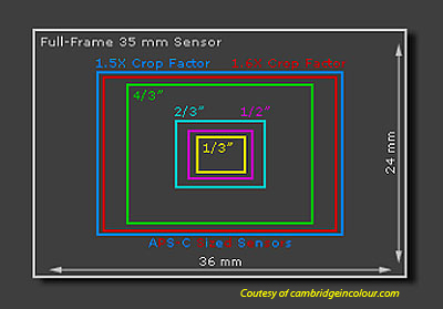

Hi Aletha - Adrian is probably right. It would almost certainly vignette. Sadly, even if your could find or make an adapter, your XL1 lens is designed to cover a 1/3" sensor - which is much smaller than the sensor area of the GH3's micro 4/3 sensor - and even smaller than the portion of the sensor used by the Extended Tele Converter (ETC) mode:
http://4.bp.blogspot.com/-ilHAFynRQX...comparison.jpg
Probably a good idea to sell the XL1 and the lens as a package.
