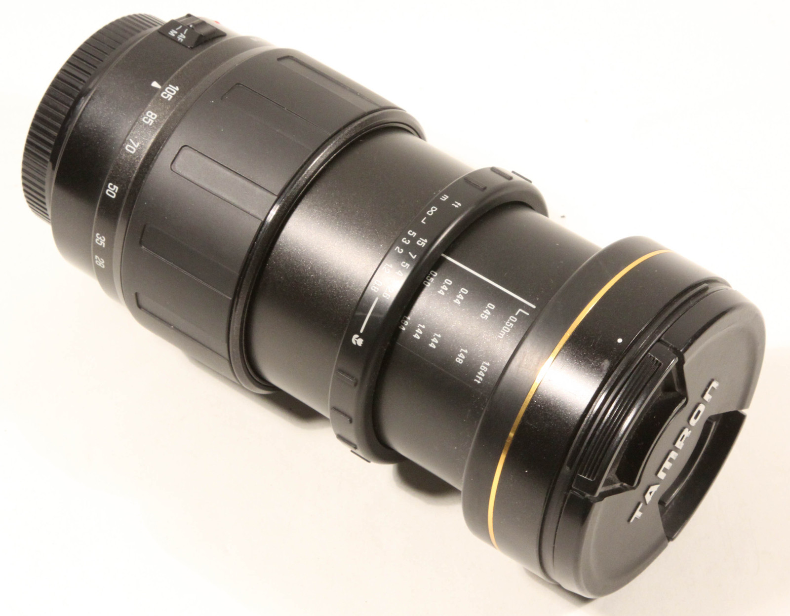

FYI: It looks like the Tamron 28-105 focus ring doesn't stay in the same location when zooming. This rules out it's use with a follow focus. Too bad.

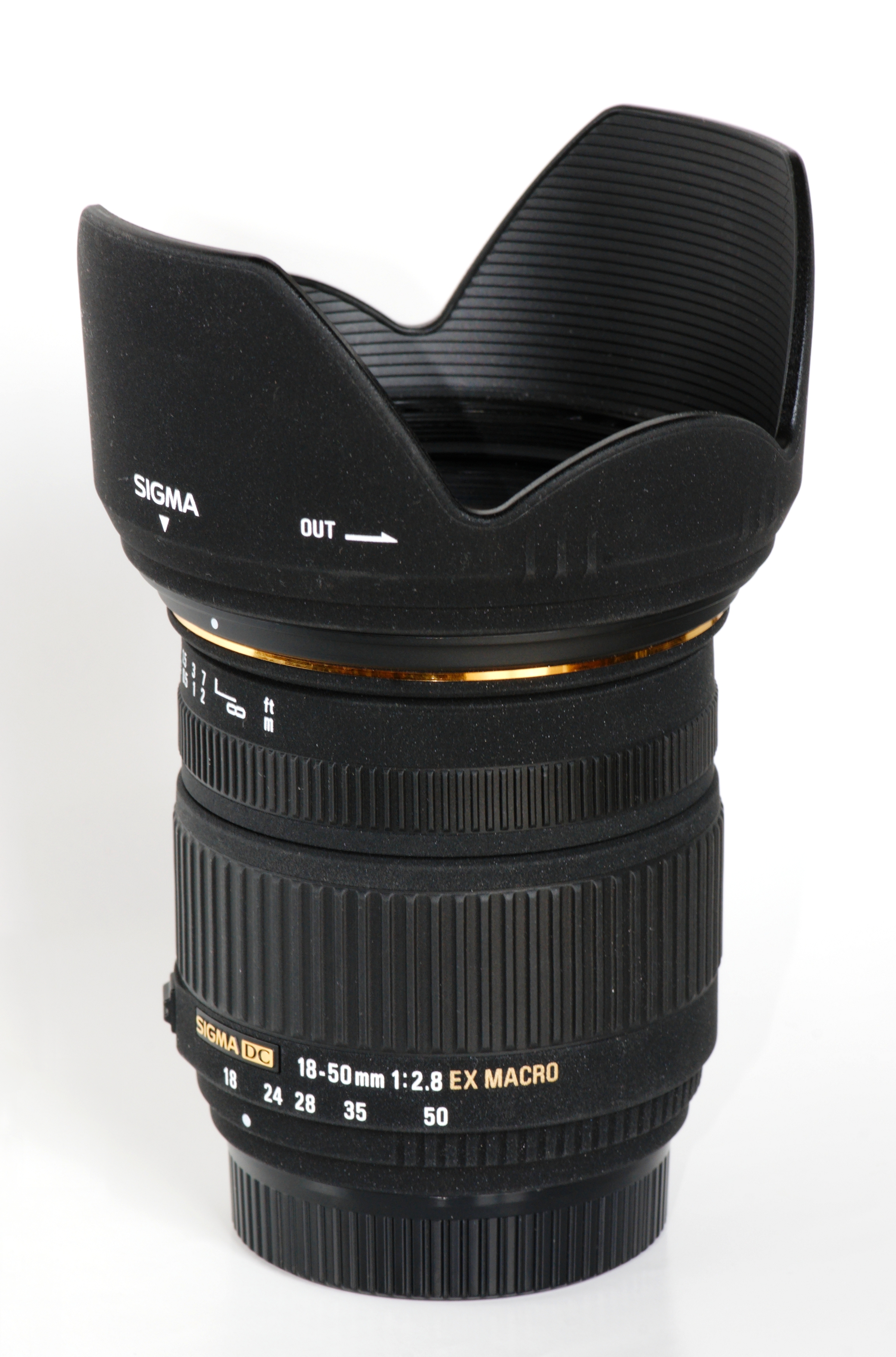

Adrian, you mention "short throw focus". I assume you are referring to a focus ring with a very small amount of rotation. I was just going to post about my experience with a Sigma 18-50 lens that I believe falls in to that category.
I took out my Sigma 18-50 f2.8 lens which I forgot I had. (it's part of my old Pentax DSLR kit that I rarely use anymore.) I happen to have a Pentax to M4/3 adapter, so I tried out the lens for video us with mixed results.
The image quality seemed great. However, the focus ring (like Adrian hinted at previously) seemed too sensitive and "short throw". In other words, if I turned the focus ring 1mm, the focus changed significantly. So making fine focus adjustments was near impossible without significant back and forth hunting for a sweet spot.
I suppose this could be resolved with a follow focus with a modified gear ratio that converts the short throw of the focus ring to a longer throw of a follow focus knob.
Maybe an AF lens is not the best option for this application.
