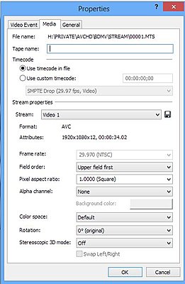

Hi William. The footage shows as upper field first, is that as it should be?

Re: HBR mode on GH2 producing 60i footage, why?
Should be good to go.
