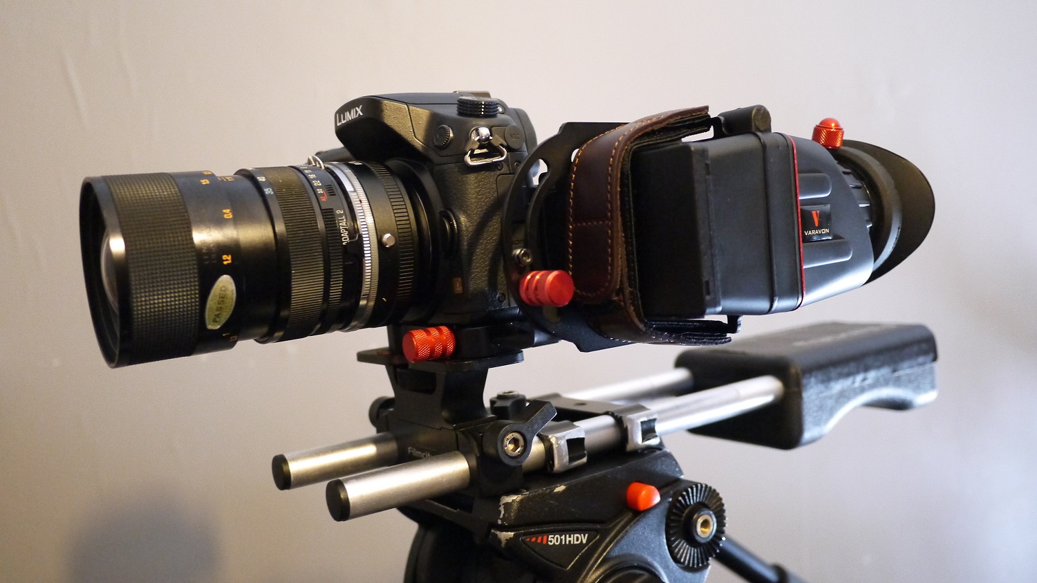

Old August 23rd, 2013, 05:01 AM   #115
Location: Belgium
Posts: 9,512
Re: gh3... any typical problems?
Got my varavon today, no weird lcd behavior with this one, my gh3 is almost ready for prime time :) There was also a sling follow focus strap included
