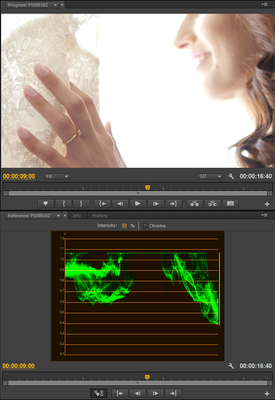

As someone who recently bought a GH4, may I ask for an explanation regarding this setting? I have set mine to 0-255 because that made sense to my somewhat lacking technical video expertise. As in, I just know 0 is black and 255 is white, so it only made sense for me to give it this max range. I am obviously not understanding this correctly.
I have since filmed 3 weddings using 0-255, the footage looks very good. As for Premiere mapping that range, do I need to do that manually? I will only start work on the first wedding on Monday, so I can't check the waveform quite yet. Any tips are appreciated, thanks :)

OK, I got home and took a look at my 0-255 footage in Premiere. That link I posted was indeed correct. You do not throw away information when shooting in 0-255, you just need to apply a fast color corrector on (probably) each clip and bring down the highlights to 235 and, at least on this clip, also raise the black input level to 16.
Unless I'm missing something, I think shooting in 16-235 from now on is the way to go.

I have also had issues with bright scenes clipping hard like that when shooting 0-255. I found that the harsh over exposure on top with bright clouds and other super bright objects is cleaner when shooting in 16-235.
