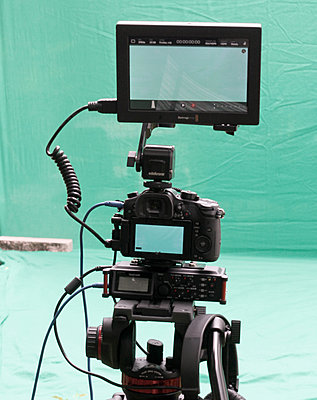

I did a quick and dirty test using the Blackmagic Video Assist 4K recording from the GH4 in 4:2:2 8-bit and 10-bit mode. I recorded internally (in 8-bit only). It was a quick and dirty shot just to see if I could discern any difference.
I shot in front of a poorly lit green screen with me running the camera and running in front of the camera, so... I'm not showing it!
But, playing with the image, the 10-bit footage from the 4K looked good to my eyes and played well within Premiere. I screwed up the exposure because I was outside trying to beat the rain. The 8-bit looked just as good. I'll try to post again with images this time, in a few days.
Basically, the GH4 plays really well with the Blackmagic Video Assist 4K. BTW, the 7" screen is awesome!
Bob Krieger is offline   Reply With Quote
