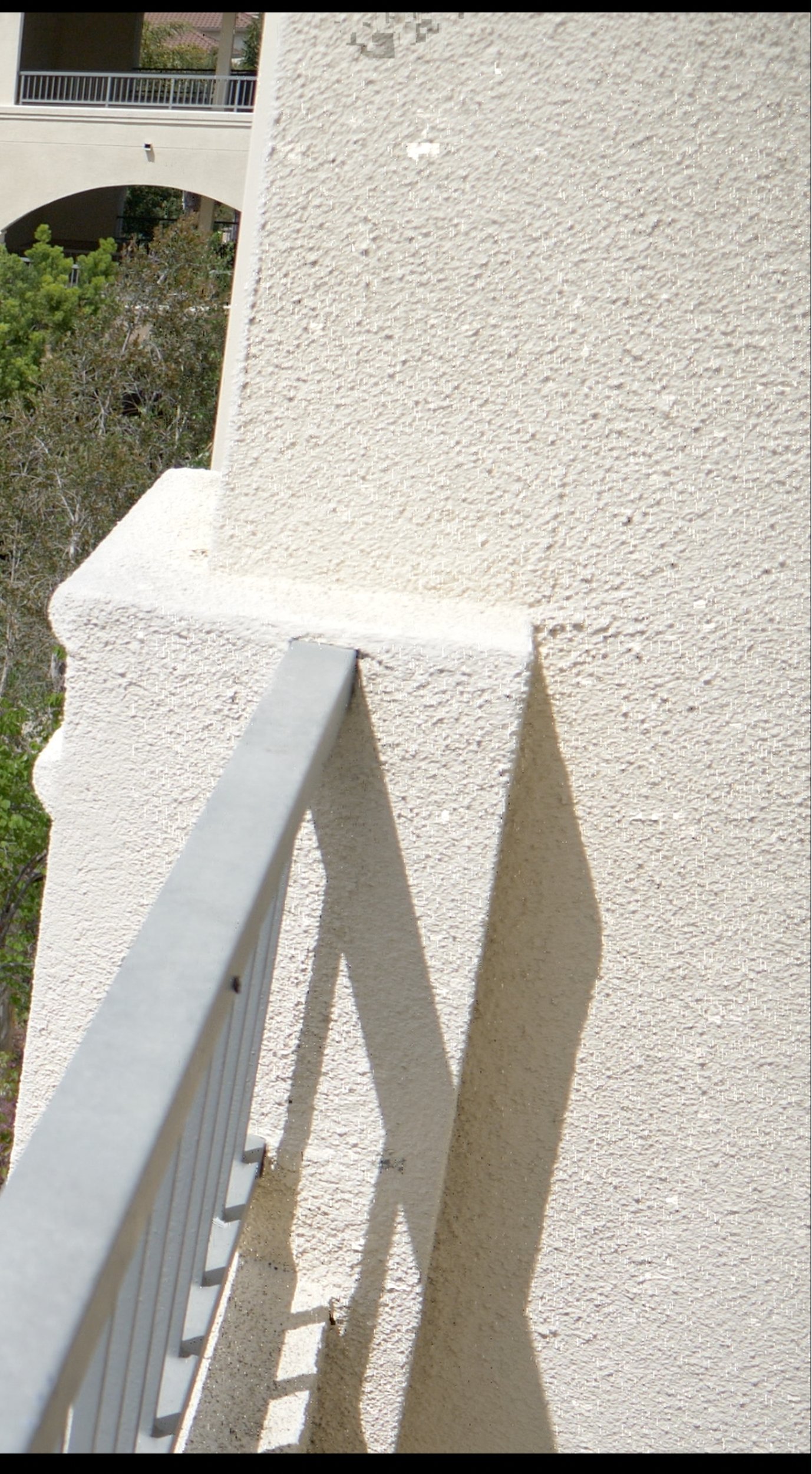

Got my GH5 last Monday. I shot a lot with it this week, stills and video, and for the most part I love it. I shot my video exclusively 8bit 60 150mb. Why?
Well, I tried the 10bit 150 at 24p right out of the box in low light (bedroom/living room with compact fluorescent lamps). The artifacting was insane, so bad I thought the camera might be broken. I never even got to color grading, these were big square compression blocks appearing and disappearing all across the image straight after download off the memory card. I have fast U3 Kensington cards, and the camera never complained about write performance, so my assumption is one of two things:
- 10bit internal recording is sort of a joke. It's simply too much data for too little storage bandwidth, at least in this first firmware release.
- In low light, the 10bit compression utterly falls apart. Mind you, 8bit looked fine in the same low light, even at 60p.
So to actually shoot at 10bit with a GH5, I expect to do so over HDMI to something like an Atomos Ninja Inferno.
Otherwise, the camera is stellar and a big improvement over the GH4.

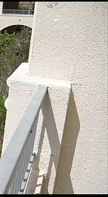

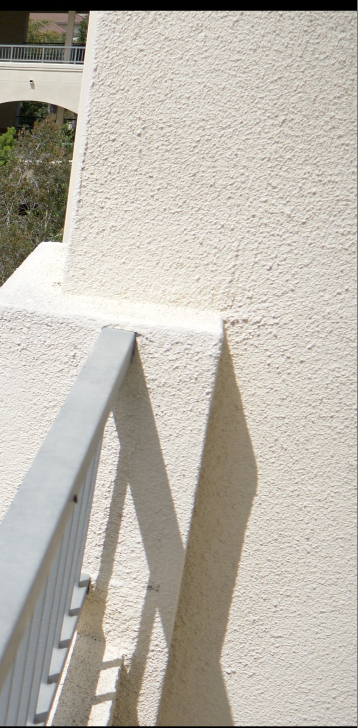

No, but I'm attaching grab of playback in FCP two frames showing the problem. Alas, the problem persists in well-lit daylight.
The first shows the issue (check the upper right of the image and note the block compression artifacts). The second shows the very next frame with no artifacts.
This is UHD 23.98 150Mbps 10bit. It may be that Apple does not yet understand what Panasonic is doing with its GH5 compression. The .MOV files are unplayable in Quicktime player, though they do import and play back in FCP.
