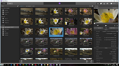

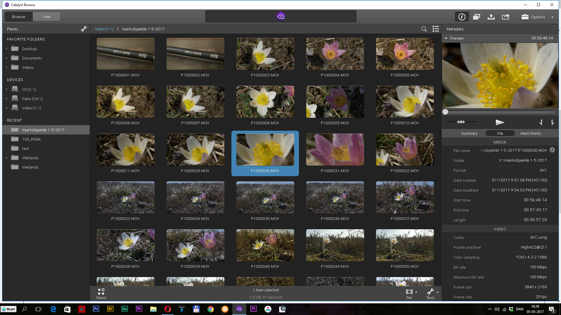

Old May 5th, 2017, 02:43 AM   #6
Location: Denmark
Posts: 495
Re: GH5 2160p29 4:2:2 10 bit workflow?
Weird - you have seen I wrote wrong it's Catalyst Browse for Sony...
