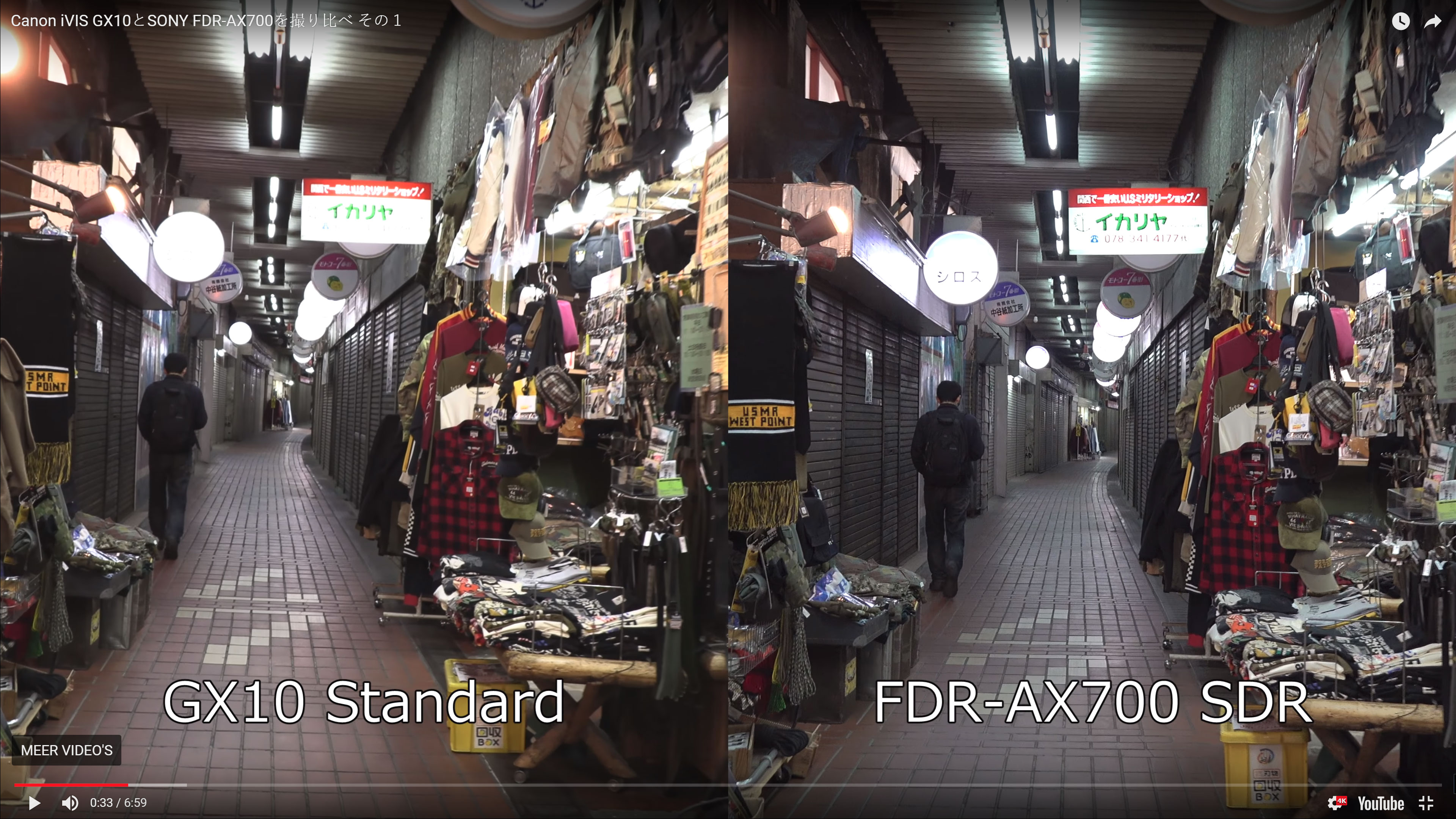

If it helps there's a series of test videos on this YouTube channel comparing the Sony AX100, AX700 and Canon GX10:
https://www.youtube.com/channel/UCB9...khKBzp9QP7_kvQ
Unless you can read Japanese it's difficult to know how the recordings were processed in post but with this one comparing the AX700 shot in SDR mode at 4K30p (100Mbps) and GX10 in Standard mode at 4K60p (150Mbps) it's reasonable to suppose that the AX700 4K30p footage was edited on a 2160/60p timeline, or exported as such:

I have watched that comparison video in 4K on a 4k pc screen and the sony deals better with highlights, is more detailed and had better stabilization, the differences are more subtle but if I had to choose between both camera I'd take the Sony over the Canon.

Based on the video I didn’t see anything that jumped out at me although youtube isn’t the best way to judge. Only thing I could see was the sony was cooler in midtones.

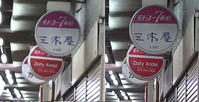

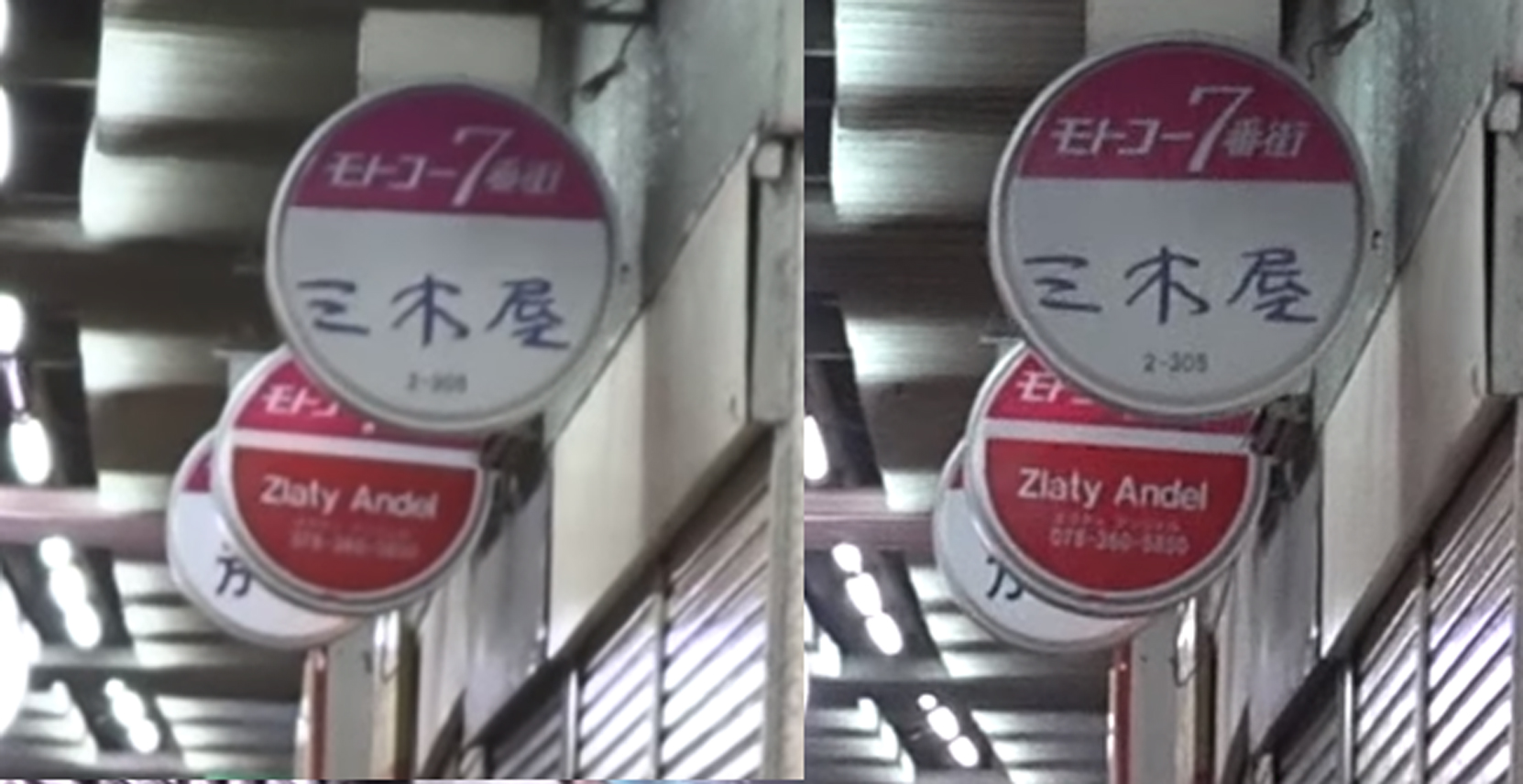

I have watched this comparison video in 4K on a 43 inch 4K pc screen and eventhough you can see youtube added compression you can see that the sony performs better, I have added one 4K screengrab and just watch the lights on top that have the advertising printed on it, second framegrab is a part of an image blow up to see the difference in detail.
Sony probably has some incamera sharpening going on because it looks there are some extra pixelation artifacts visible round edges which the canon doesn't show so you might get equal or better results if you sharpen the canon in post but since we don't have access to the files straight from the card we"ll never know. One thing I do see clearly is that the sony "appears" to be more detailed.
Also the stabilization difference is best seen on a big screen, it is a subtle difference but it is better on the Sony.
GH5 for video documentaries: some questions please.-gx10-ax700comp02.jpg

The first image apparently didn't upload? Here it is again.
GH5 for video documentaries: some questions please.-gx10-ax700comp01.jpg

We unfortunately do not know how the autofocus systems were set up either so interesting test but not conclusive. Still if one needs 50/60P UHD there is only the one choice. The Canon looks a little over exposed in a lot of the shot. At the 800% gamma may need a little grading to look really good. I think there is also a test of the GH5 vs the XF400 of a train too. GH5 clearly sharper but again were they in autofocus and at what settings as both have a lot of controls for auto focus.

I can see the sharpness difference in the close up. In the second capture the gx blows out the signs more but as the video progresses this goes away. This has more to do with auto exposure. You want to give the edge to Sony that’s fine but nothing you’d be able to spot without a side by side.
