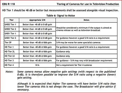

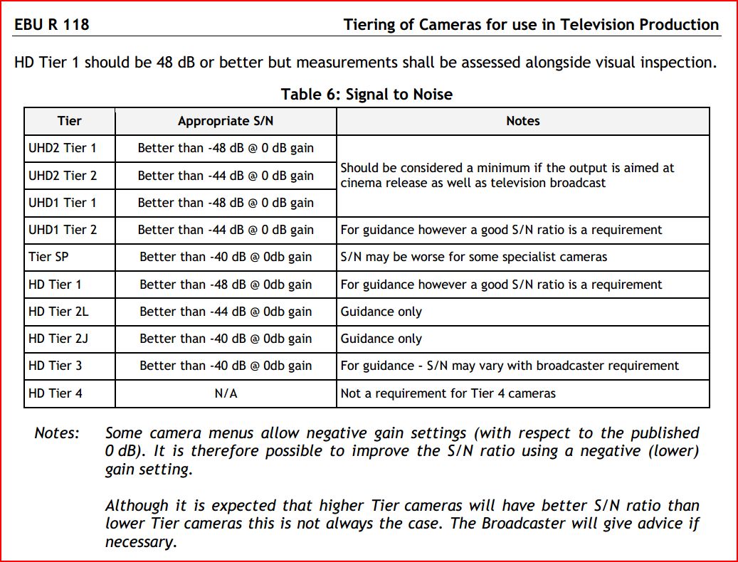

What kills most cameras from the EBU and BBC's point of view is PSNR more than pixels and sensor size. Noise levels in images aimed at broadcast need to be tightly controlled due to the signal path losses in amplifiers, attenuators, signal splitters and combiners, lossy cables etc in the transmission path.
Tier 2 UHD requires a signal to noise ratio of 44dB at 0dB gain. The best test results I have seen from a GH5 are around 41dB which is if you understand the dB ratio curve tells us that this 3dB difference in SNR means a doubling of noise. For broadcast this is a major influence in what cameras are acceptable.
https://www.dxomark.com/panasonic-lu...in-the-lineup/
EBU Tiers here:
https://tech.ebu.ch/publications/r118
Most decent 3 chip 2/3" cameras such as a Sony PXW-400 can deliver a PSNR of up to 62 dB in the Y channel with noise suppression on. In reality as an RGB output signal this would be closer to 55-57dB. On that basis all the DSLR/mirrorless cameras are way outside the higher end tiers for broadcast acceptability. Even the venerable old Sony EX3 1/2" chip cameras delivered 54 dB in the Y channel. Canon's new C200 delivers 53dB (Typical) in 50Hz mode. Sony’s FS7-F5-F55 range deliver 57dB.
Basically if whoever you are shooting for is going to use the EBU Tier system to determine what camera level they want you to shoot with and want you to meet Tier 1 in either HD or UHD the camera needs to deliver better than 48dB. Most S35 single chip cameras need to be delivering figures well in excess of 48dB for a good SNR in a 10-bit 4:2:2 recording.
Why is this? As we can see from the table below to record a true full 10-bit image we require a dynamic range of 60dB. To deliver a full true 8-bit signal we require a dynamic range of 48dB. Cameras that deliver 10-bit 4:2:2 recordings really require a SNR of 60dB to ensure that most of the information is signal rather than noise in that 10-bit container. In practice and reality this is not the case but one cannot get away from the fact that the better the SNR is of a camera the lower will be the noise component of that signal. Quite well put here:
https://www.provideocoalition.com/s_...s_demystified/
SNR is expressed in units of power or decibels (dB).
SNR (dB) = 20log (Signal e- / Noise e-)
8-bit 256:1 48dB Dynamic Range
10-bit 1024:1 ( 4x Increase) 60dB Dynamic Range
12-bit 4096:1 (16x Increase) 72dB Dynamic Range
14-bit 16384:1 (64x Increase) 84dB Dynamic Range
16-bit 65536:1 (256x Increase) 96dB Dynamic Range

Answer this: If new broadcast deliverable standards demand Super35, what about MFT?-ebu-tiers.jpg

Interesting there is a little footnote on negative gain settings. That has been a debated topic in the past as to whether negative gain actually gives you more usable SNR or if it really just brings the same range, shifted down by the 3dB for example.
Kevin Lau is offline   Reply With Quote

True Kevin you are correct technically but in practice I've found most cameras that are capable of anything delivering around ten stops or better with a dynamic range in excess of 50dB suffer very little if anything visually when going out to a six stop Rec 709 range. I've worked on plenty of live OB's and visually seen nothing when we have tried negative gain. Sure from a post point of view the quieter the image the nicer the look generally.
Chris Young

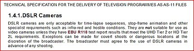

With regards to DSLR, and this applies to Mirrorless as well, the BBC are quite adamant about the use of these cameras. This information can be found on page 8 of the
TECHNICAL SPECIFICATION FOR THE DELIVERY OF TELEVISION PROGRAMMES AS AS - 11 FILES
This also applies to the following channels in the UK.
BBC, BT Sport, Channel 4, Channel 5, ITV, Sky, STV and TG4
As for the 60Hz world most of that is governed by SMPTE spec so that may be totally different. That said I've seen all manner of "non-broadcast" spec cameras used in all manner of broadcast productions. I do have to say though that the Beeb were always one of the toughest to get program tech clearance through. A few years back we produced a 13 ep series for Granada in the UK and whilst I always aimed for the maximum delivery quality I have rarely ever had a series accepted without some kind of a tech query but in that case all went through without a question.
My motto is if you can get a type of camera and kit or anything else accepted go for it but do your homework first. If necessary discuss with the broadcaster and submit any supporting tech material for the kit you want to use along with some footage samples If they sign off on that all well and good. If you can deliver quality like this off a GH5S I would be asking for sure:
http://dpp-assets.s3.amazonaws.com/w...rdsBBCFile.pdf

Answer this: If new broadcast deliverable standards demand Super35, what about MFT?-bbc-dslr.jpg
