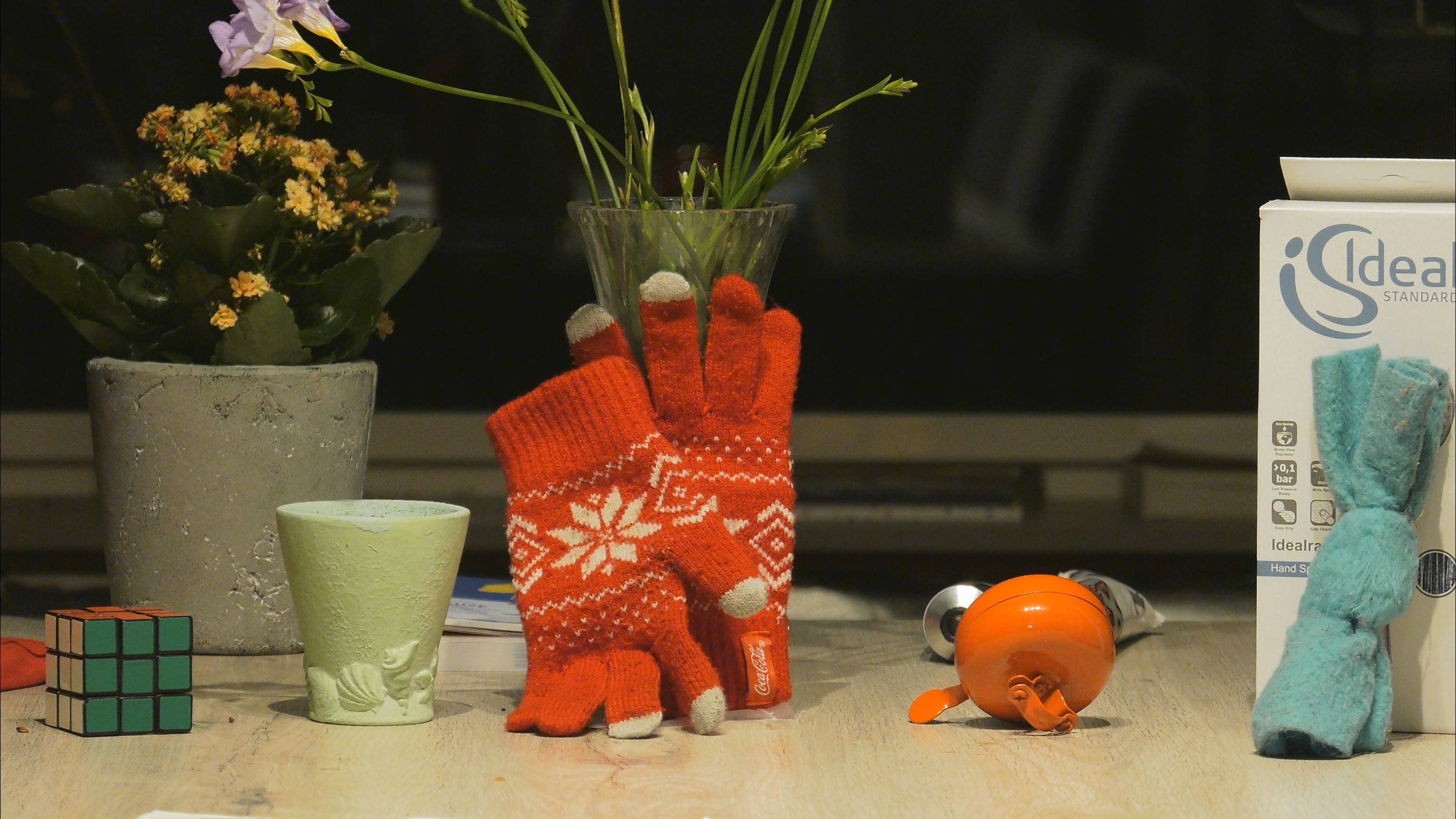

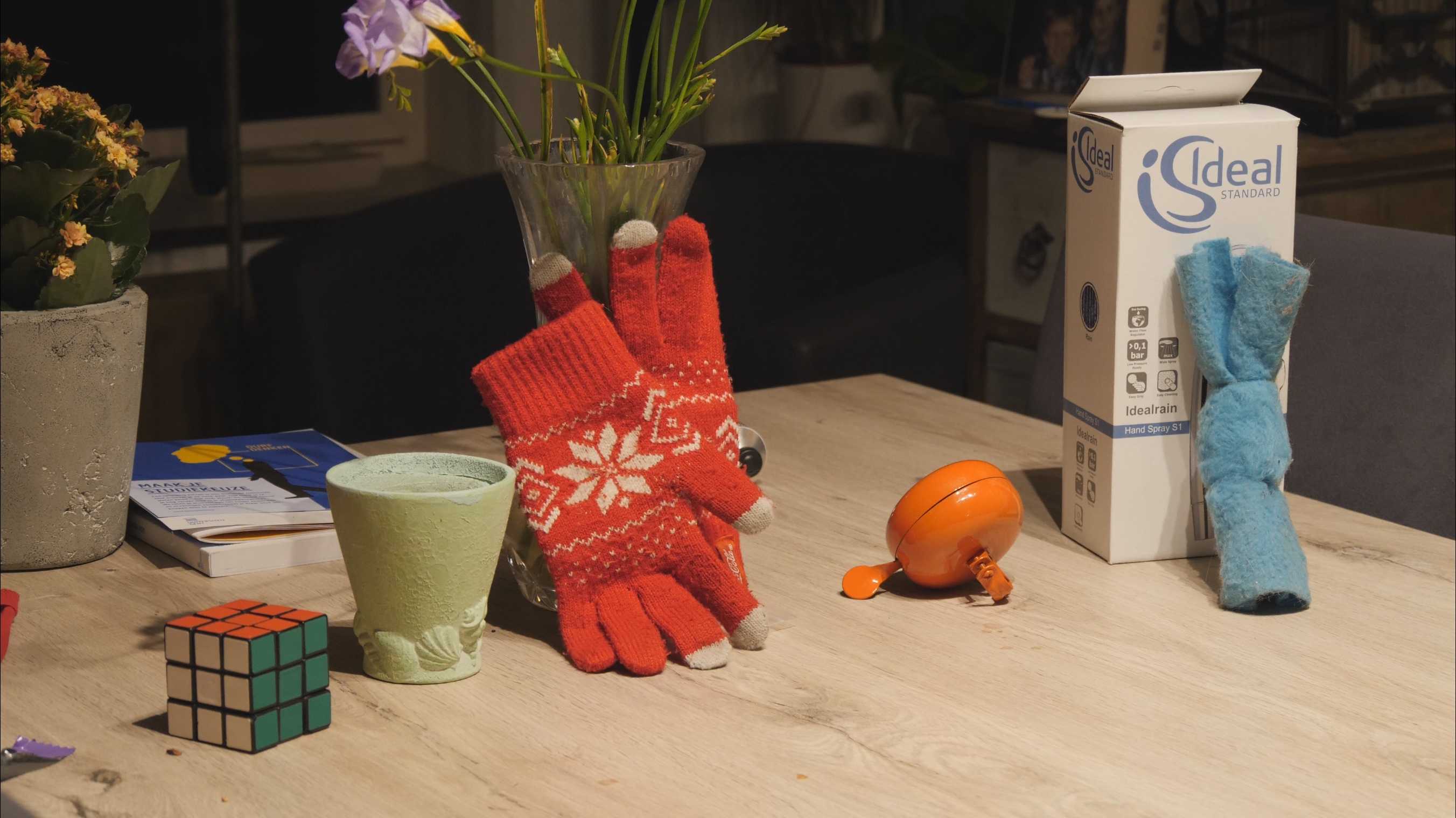

Re: matching GH5S and DVX200
I tried to match both with natural setting on the GH5S and the GH4 still like scene file on the DVX200. Both with tungsten preset. The DVX200 has too much yellow. I don't see this with other scene files so I guess it is the GH4 still like scene file.
In the color correction setting in the menu you can change yellow color and phase but I have no experience how to change this. I guess I will screw this up.
So how can I best lower the yellow tint to match them perfectly?
Front view is the DVX200 (more orange) because of the yellow tint I guess (too much yellow in red = orange)
