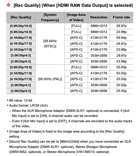

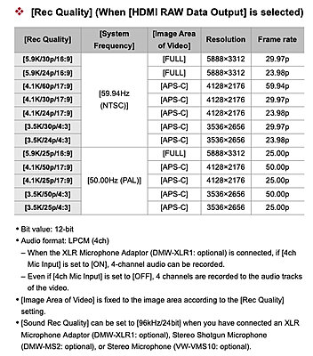

I'm making comparisons to the S1H and newer S5iiX, however I can't find anything that discusses the actual output from either camera.
The Panny manual just shows frame size and frame-rate. That's only 1/3rd the required info needed.
What's the bitrate at 6K 24P? The color space, 4:2:0, 4:2:2...? I can't find anything that gives those specs.
Anybody know,?? Don't bother guessing or making assumptions, I need real-world data.

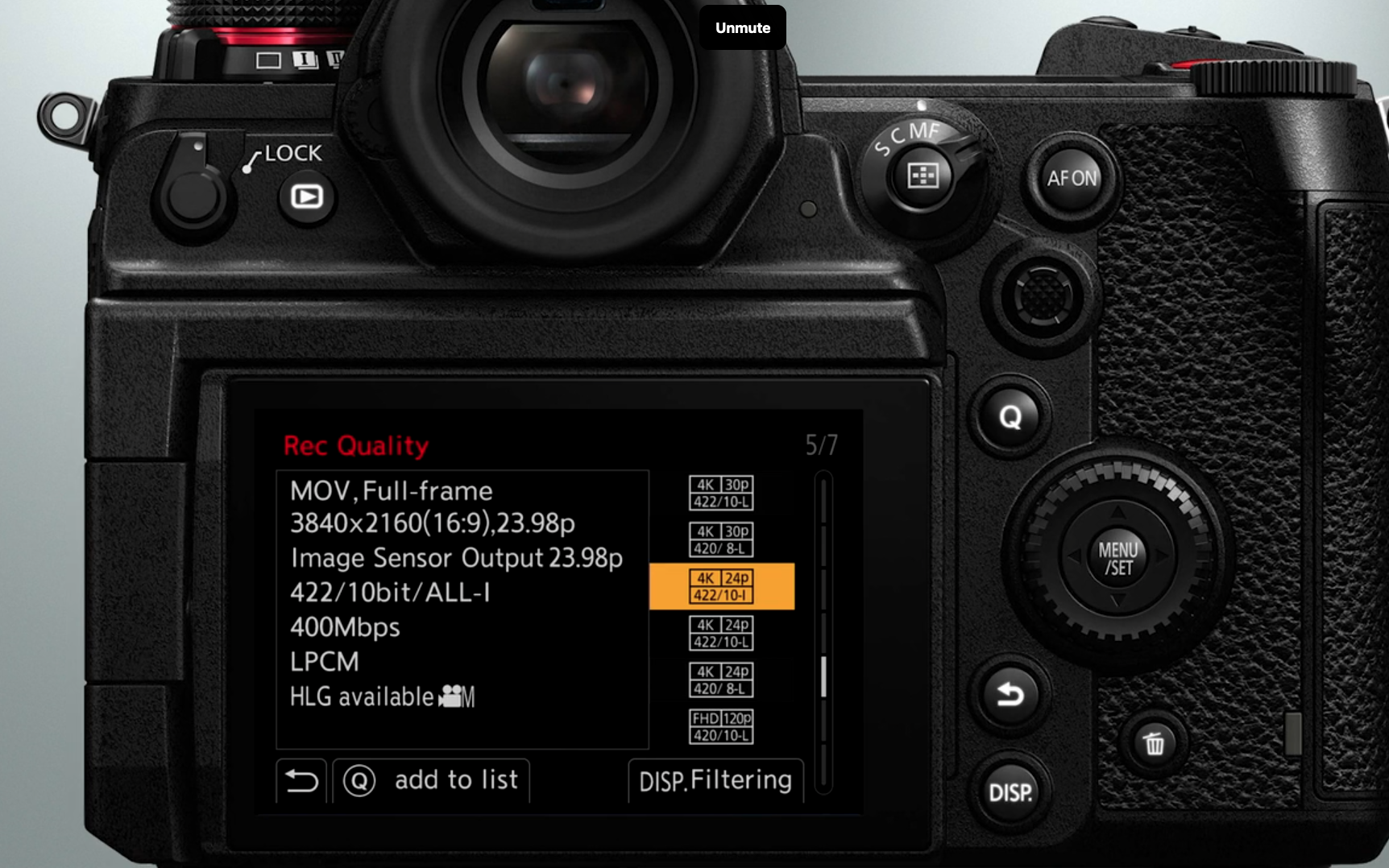

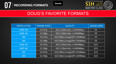

I don't know anything about the S5iix, but if you can get your hands on a S1H, all of that information is shown right onboard the camera as you scroll through the various combinations of codec, resolution, frame-rate, etc. I'm 1500 miles from my S1H and won't see it again until October, so I can't help with more details.

Precisely what I needed and proof the S1H is the perfect hybrid for my needs.
Needed the high bitrate 4K 10-bit 422 color for video and, the ultra-high resolution EVF for stills shooting. (I only use manual-focus film lenses so AF is useless, but a good finder is gold. Closest to an optical finder I've seen on any camera.)
