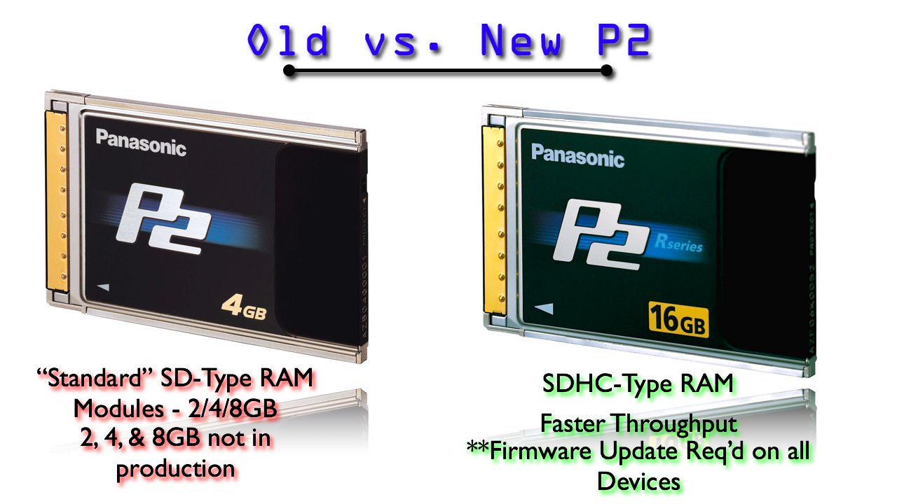

The original 2, 4, and 8GB P2 cards had no identifier in the product name and used the older, original SD-type memory modules. The type "R" refers to the newer cards - 16GB and higher which use SDHC-type modules for greater capacity/throughput. Maxell may simply be using their "A" designator to create a branding differential between Panny and Fuji product.

As it was explained to those of us who were Panny consultants in '06 the "R" designator was as much for marketing as it was technological differential. The structure of the card didn't change but it's capabilities did with respect to data size and I/O speed. There was also a change in in-camera communication parameters which required firmware updates to talk to the newer cards, however all P2 devices produced after the release of the Type-R card came with the updated firmware. See the enclosed slide from a Keynote I created for the P2HD roadshow in '06:

The "A" series denotes an uptick in the record and transfer speeds, it is now 800Mbs up from 640Mbs.
The "R" series while using an SDHC memory, also did wait to have the memory incorporated into an SD container to be used like the 8GBs and lower. The memory "sites" are incorporated into a larger memory/LSI/RAID so if you were to open one, it looks like one big chip in there.
