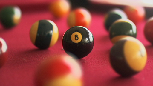

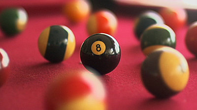

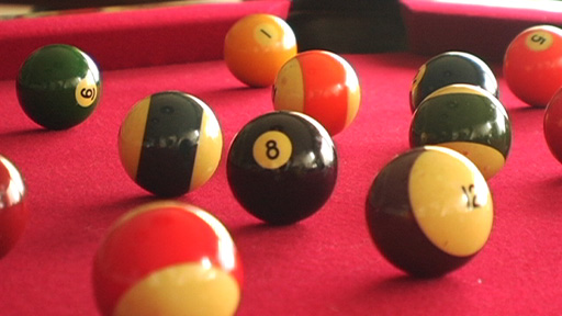

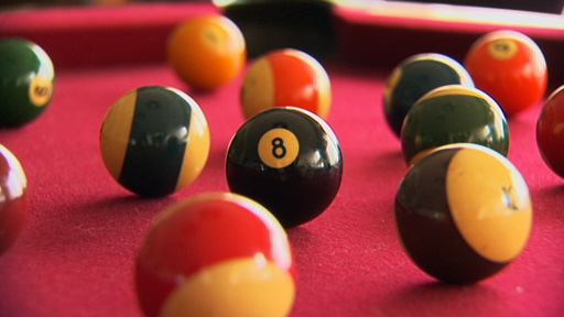

Here are some frame grabs of a test I did years ago with a DVX100 1/3", DSR-450WS 2/3" and DSR-450WS with a Pro35 adapter, 85mm Zeiss Super Speed, all at the same aperture of f2.8 and framing matched with cameras in the same position.

I guess I mis-spoke regarding the towards the wide end of the lens comment. Sure, DOF increases with wider fields of view. What I was thinking was a lot of the zoom range has most everything in focus.
When I look at Jeff's example, the 1/3" chip image does not hold my attention from a "look" point of view, and that is at f2.8 at smaller aperatures the walls would start to be in focus. If one were to shoot an entire pool related video, would you rather watch the 1st image or one of the other two? Just my opinion that the 2nd and 3rd image have a more porfessionally shot look. This does not mean people who use 1/3" chip cameras are not professionals, I use a 1/3" camera too. Please don't anybody go there. Now the 1/3" chip could function nicely in a role as a deep DOF style shot, but that would part of a group of cameras.
But if you had to present something to be judged with one camera, what would you put your name on if you had the choice?

Yes Jeff, sometimes it makes a difference!
