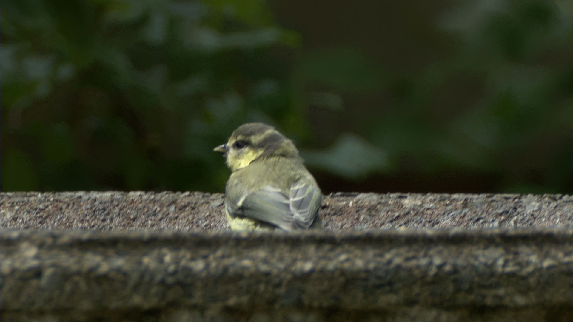

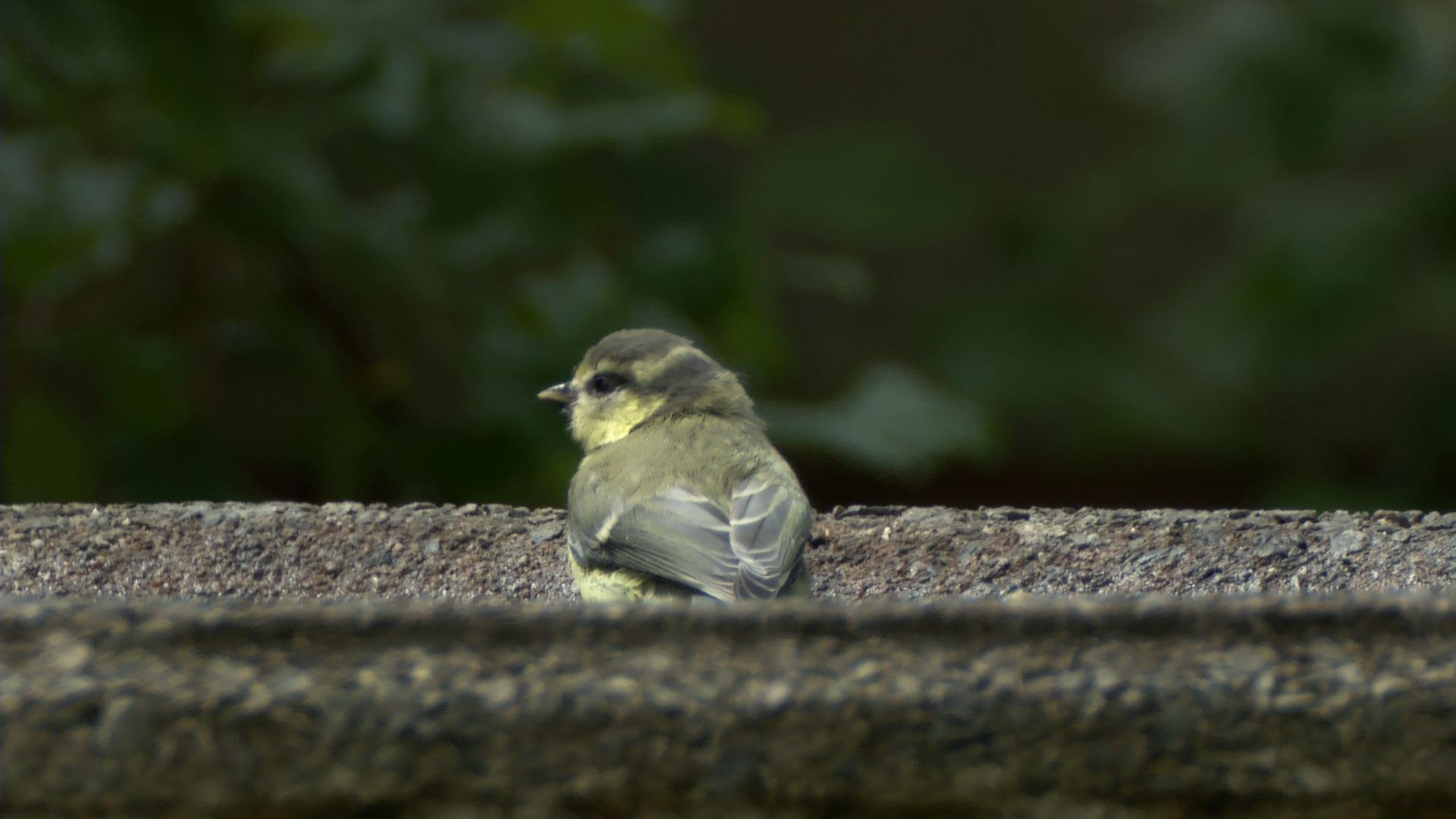

Every time I do a move there is massive noise in the background. The first frame grab here is when the shot is static and the second one 2 frames later as it starts to move.
This doesn't look right to me, any ideas?
Steve
Just looking at stills is always awkward, but it looks like the camera is using quite a bit of temporal electronic noise reduction to try to help mask the noise off the chips. It seems to be doing a reasonable job on static subjects, but is confused by movement (not surprisingly) - I assume it is relying on comparing static subjects on a frame-by-frame basis. What gain setting were you on?

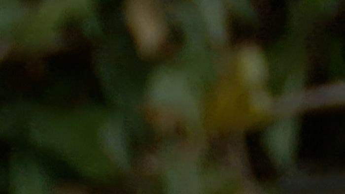

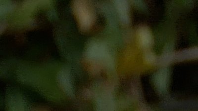

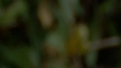

Here's another cropped area.
The first shot is on static, the second is about 3 frames later as I start to pan.
Steve

Posts: 2,699
Originally Posted by Dan Brockett View Post
You are aware that Cinelike D is the noisiest gamma setting, right?
I don't think that's really relevant here - the issue is not how noisy the camera is in itself, but how the noise increases on areas of movement. A different gamma setting may make a difference to the overall noise level, but is unlikely to affect what Steve is seeing.
Barry Green did some evaluation when the 370 was released and if I recall, the 370 was a hair cleaner than the EX1 in some settings and just a shade less clean in others, but that is very clean,
The question Steve's findings raise is how is it achieving that cleanness? The 300 was slated for poor noise figures, the 370 was brought out as the answer. I still can't think of a more likely answer than what I previously suggested - that electronic noise reduction was incorporated. And Steves examples seem to indicate it falls apart under certain circumstances.
Steve, have you still got the camera? If so, are you able to compare the AVC-Intra recorded output with the live output? (Or record the latter on something like a nonoFlash?) I find it hard to believe it's a codec issue, and if the live/recorded feeds show the same effect it would rule it out - would back up my theory about it being due to the front end.
The other thing I'd try is seeing how it behaves in low light with gain. Any noise reduction circuitry may not work as well then as at low gain settings.

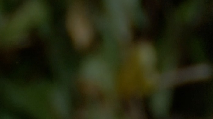

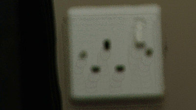

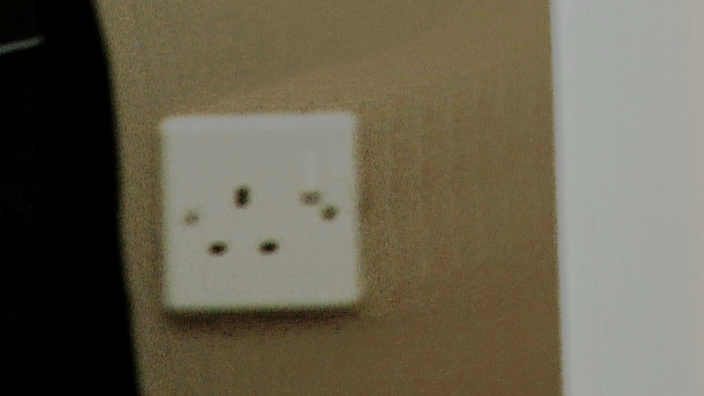

It's not a pretty picture!
Here are a couple more grabs, there is some weird streaking going on here.
These are while moving the camera, and something is not keeping up. Look at the second shot and you've got multiple images of the plug holes.
These are crops and with levels boosted a bit just to make the problem a bit more visible, but it is very noticeable on the original moving footage and through the viewfinder while shooting.
Steve
