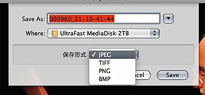

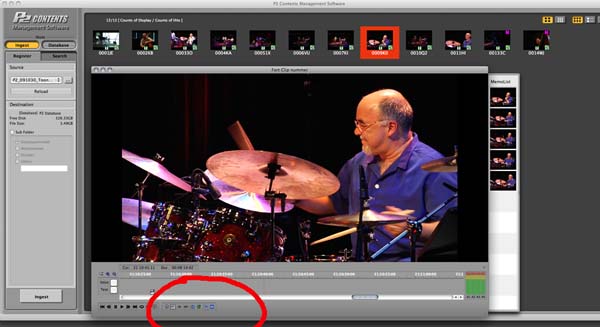

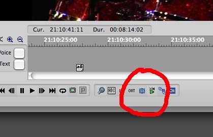

the fastest, simplest and easiest way to do this is within the P2CMS software tool from panasonic, I suppose this is the viewer you're referring to in your post? First select a clip, play it in the viewer, navigate to the right spot and then look for the little blue crosshair on the bottom of the window (see the example i attached) click it and then save it to your disk. Remember that the size of the viewer will actually determine the size of your still. A little desktop 'real estate' wouldn't hurt, especially when you're shooting (and grabbing) Full HD.
