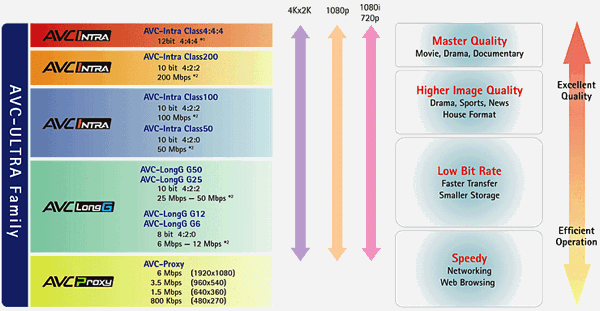

What the Heck is AVC-Ultra?
Panasonic has always been a leader in video formats and codecs. They were on the fore front of the DV native to edit revolution. They were the first to offer 4:2:2 50 and 100mbps versions of DV, called DVCPro. They introduced their next-generation format AVC-Ultra back in 2007, years ahead of Sony’s next-gen format, and even a little ahead of Apple and ProRes. AVC-Ultra has evolved a lot over the years. The most critical part of AVC-Ultra is that nearly all variations are at least 10-bit 4:2:2.
First, you have AVC-Intra. These are Intra-Frame formats, recording every single frame of video in full quality. These run at 50mbps, 100mbps, and 200mbps. The 200mbps variation is 4:4:4 12 bit. Next you have AVC-LongGOP. Still maintaining 10-bit 4:2:2 this LongGOP format runs at 25mbps, 36mbps, or 50mbps. As of this writing Panasonic has also announced AVC-4K. At this point specs are a little vague on what exactly that will look like. We know it will be at least 4:2:2 10b-bit. But it could also be 4:4:4 12-bit. At 4K resolution 4:2:2 10 bit would run about 400mbps in AVC-Intra. At 4K resolution 4:4:4 12-bit would be a whopping 800mbps in AVC-Intra.

While I understand the basic intent of your post, there are some facts that could be better verified...
First, on timing...ProRes was also introduced in 2007, so I don't understand your reference on being ahead of ProRes...and Sony doesn't use AVC-Intra, so the "lead" is really more of a "choice" as Sony has gone ahead with other formats (HDcamSR is MPEG-4 I-frame, but since it was introduced in 2003, the "lead" assertion still doesn't apply).
On the specs, AVC Ultra is a family of codecs including all the AVC-Intra and AVC LongG (as well as AVC Proxy) varieties.
AVC Intra at 50 Mbits/s is not 4:2:2...it's 4:2:0 (and it's less than full resolution).
AVC LongG(OP) is not 10 bit, 4:2:2 in all of its variations, G12 and G6 class are 4:2:0, 8 bit.
Of course, AVC Proxy is just that...proxies. (they don't really apply to the recording format discussion)
AVC-Intra is a great codec, and the quality is very, very good. I just bristle a little when the specs get so generalized that they're not really completely accurate as someone will almost certainly be confused...

Actually, now that I click on your graphic, I see the info I pointed out is even on there...
I used Panasonic's whitepaper revision from February for reference.

Thanks for providing additional information. It's always great having someone to keep me on my toes and iron out the details.
You're correct, ProRes and AVC-Intra were both introduced in 2007. However, in from my perspective, AVC-Intra was a far more fleshed out acquisition format at the time of introduction. The original rendition of ProRes was to be a high quality intermediate post codec but it grew into much more over time. Therefore i would say that AVC-Intra was ahead of it, from an acquisition perspective.
I am aware that Sony does not use AVC-Intra (i've been an authorized Sony representative for nearly 25 years). I should have been more clear. I used the term "next generation format", which is vague. To clarify i was intending next gen to refer to formats that are going to be a big part of the companies future at this point. My own perspective is the XAVC is going to be Sony's go-to format of the future, It delivers comparable (to AVC-Intra) 10-bit 4:2:2 specs at similar bit rates. HDCamSR never has been distributed below $30k. But your greater point that in this industry it's not usually a "head to head" so much as companies stair stepping each other i totally agree with.
You are correct, AVC-Intra at 50mbps is the only Intra-frame that isn't 10-bit 4:2:2 (or higher). Thank you for mentioning that as i didn't make that clear.
I was speaking of bit rates of at least 25mbps or higher, as i made no mention of the 12 or 6 formats. My perspective is most people wouldn't acquire their primary footage at these bit rates, thus i didn't mention them. You are correct though, those formats are 8-bit 4:2:0.
Thanks for keeping me honest and on my toes.
