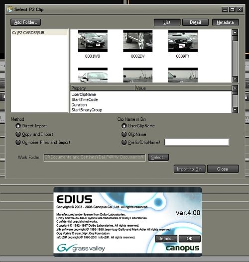

I didn't know that it was so EASY to manipulate those cards and files! Just by curiosity and at home I decided last night to install Edius 4 on my dam old P4 2.0GHz with only 768GB of ram... Installed the CAM and P2 Store driver, the P2 viewer... and go... Edius found the video in seconds and I could make a 30 sec clip within minutes, even better I could do all this editing without ANY lag or whatever on my 4 year old PC... AMAZING ! Everything was smooth even the preview. In the past I tried Vegas 6d on the very same configuration... I could not even watch the previous... too much lags.
Now I was wondering that I may not be able to afford 3 8GB P2 card and P2-Store by Camera, and I was wondering what IF... I just have 1 P2 Card, can I edit this without having a PCMCIA slot, HVX-Camera or P2-Store plugged to my PC? The answer is YES ! Just copy the files on your HDD, Go in Edius 4 to Capture P2 Select, choose the correct folder and... HERE you are! This means that if you do not have ANY of the P2 products near you, you can always read and edit file if they are stored on an external HDD!

Well I have Edius Pro 4, I didn't even know that the Broadcast version was needed. And you are right, on Canopus Website it is clearly stated that the Broadcast version is needed...
I just Download the Trial Version of Eduis Pro4 and tried without thinking of this, since I always heard that it would work (I am a Vegas user). Before jumping to Edius and give them my money just wanted to make sure it will work flawlessly
Anyway look this is a screenshot for you, it works

I just Download the Trial Version of Eduis Pro4 and tried without thinking of this, since I always heard that it would work...
That's funny, I was just told a week or so ago that the trial version wasn't supporting P2 at this time either. Maybe they updated it - I'll have to take another look.

AFAIK, Edius Pro now has all the features of the Broadcast version as standard. I think they updated it sometime in the past 60 days... Either way, Edius is the way to go for editing with the HVX on PC. Now if you need more elaboarate capabilities that Edius can't handle (stuff that Vegas, Avid and the like can do), there are other options. But none as elegant or as well integrated with the level of support for the MXF format and DVCPRO as Edius is.
