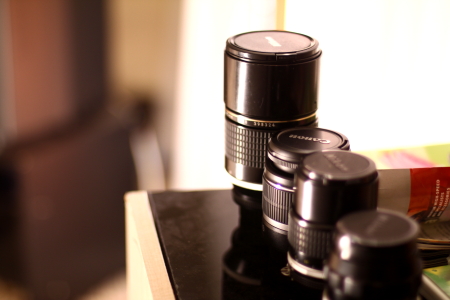

I'm using i just picked up some Nikon lenses. Once I fiddle around I'll post some shots.. From preliminary usage, they're looking pretty nice!!
