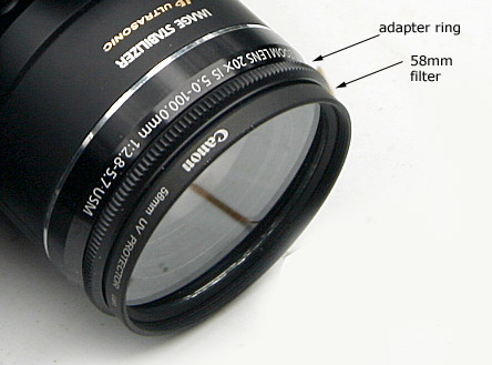

Originally Posted by John Abbey View Post
the lensmate adpater is a bayonet mount that goes on end of the sx20 lens, and has 58mm threads on the other end..
OK -- so HOW does it connect to the SX20 lens if it does use the threads?
And, what about a lens hood?
When I put my 52mm ND on the Sony 52mm -- the Canon hood no longer fits.
PS: I'm still puzzled by how there can be two different 52mm sizes? One screws in and one doesn't.

I just bought then returned a 52mm UV filter yesterday. The size was right, but it looks to me like the Powershot is grooved rather than threaded. I could twist it in a little but I couldn't tighten it. It just sort of sat there loosely.

as I have mentioned before, you have to buy the adapter for it that is grooved for the 52mm bayonet style mount on the end of the lens..this adapter has 58mm threads on the other end for your filter..works great.you can then attach your lens hood to the filter if you like..it is impossible to attach any filter directly to this camera lens.

OK, I get it now. You use this adapter:
Lensmateonline - Canon PowerShot SX20/SX10 & SX1 IS
Just one more question. It looks like you might want to get one for each filter you use (say one for a UV filter and one for a polarizer) in order to be able to change it quickly. Is that what you do? Not too horrible at $15.95 each.

well you could do that but not needed. just grip the adapter and unscrew the filter, put on another one..or better yet, just leave the UV filter in place all the time and just screw another filter on top of that..note you may get vignetting at the full wide setting. And whats going to make this camera even better than it is, is the chdk firmware hack will be available soon (its in beta now) and you will be able to shoot raw and get access to the superfine jpg setting among other things..
So the end of the lens is 52mm and it is grooved, but it's "groove" is not the same as a 52mm filter thread. Correct?
So, somehow, my 52mm Sony ND filter must have thread that fits in where the adaptor goes.
Now my problem is that I own an $80 52mm ND filter, but I suspect the 52mm adaptor can't accept a 52mm lens. Unless, the make one that doesn't alter size.

the end of the lens is 52mm, but its not threaded ! it is a weird bayonet mount..thats why you need that adapter and yes you have to use 58mm filters with it.

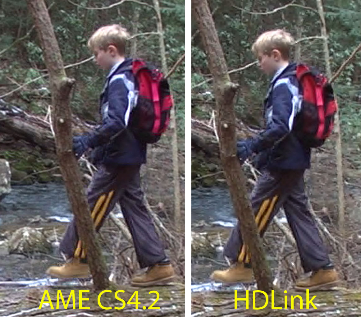

Quote: The whole CineForm premise is that there is an advantage to not editing native formats .... no intermediate is needed with any current pro editor.
I disagree. AVCHD decoded directly by current Adobe products (AME, Premiere) gives a poor result, with chroma artifacts that can be avoided with a Cineform workflow. See for example these images, which are framegrabs from 720p60 AVCHD from a HMC40, converted to avi using AME vs. HDLink (i.e. Cineform). Compare the edges of the red pack.
There likely are poor AVCHD and H.264 decoders used by some NLEs -- and I should have thought of that. My bad.
There's been a lot of encoder comparisons, but I don't know about decoders. I would expect CineForm to be one of the best. My problem is that FCP uses ProRes and Avid uses DNxHD -- and both have their own real-time engine. As I remember, CineForm can't run under Apple's or Avid's real-time engine.
So that leaves Premiere because Adobe allows it's real-time engine -- which isn't real-time at all -- to be replaced by CineForm's engine. But, now Adobe has developed a GPU RT engine for Premiere. I wonder if they will allow it to be replaced. Maybe we will find-out at NAB.
