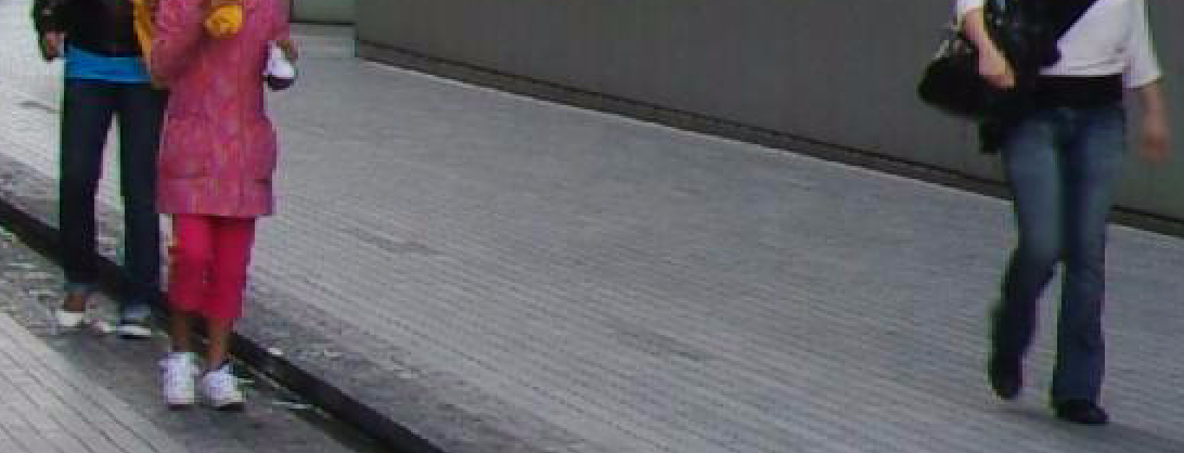

If you take a frame (say from the video 3) you see colour moireing over the grey areas indicating downsampling problems with the debayering. Also the compression is really quite harsh too, the people look very pixellated, the person with the red top looks like the colour sampling way lower than the resolution (even at 4:2:0).
I've included a crop example (the original is mjpeg so each frame is self contained and i saved it with jpg maximum to preserve it).
This is not 1500 x 1024 resolution in anyones book, a decent 720p has far more resolution than this.
I really hope i don't sound like i'm trolling here, but i see a nice active forum with people using dSLRs and it makes me wonder what i'm missing! These cameras produce wonder stills and have great sensors, the compression and downsampling from native resolution is killing them.
I'm going to put together a comparison image with the 7D, Pentax and the little LX3 to try and show what i'm seeing.

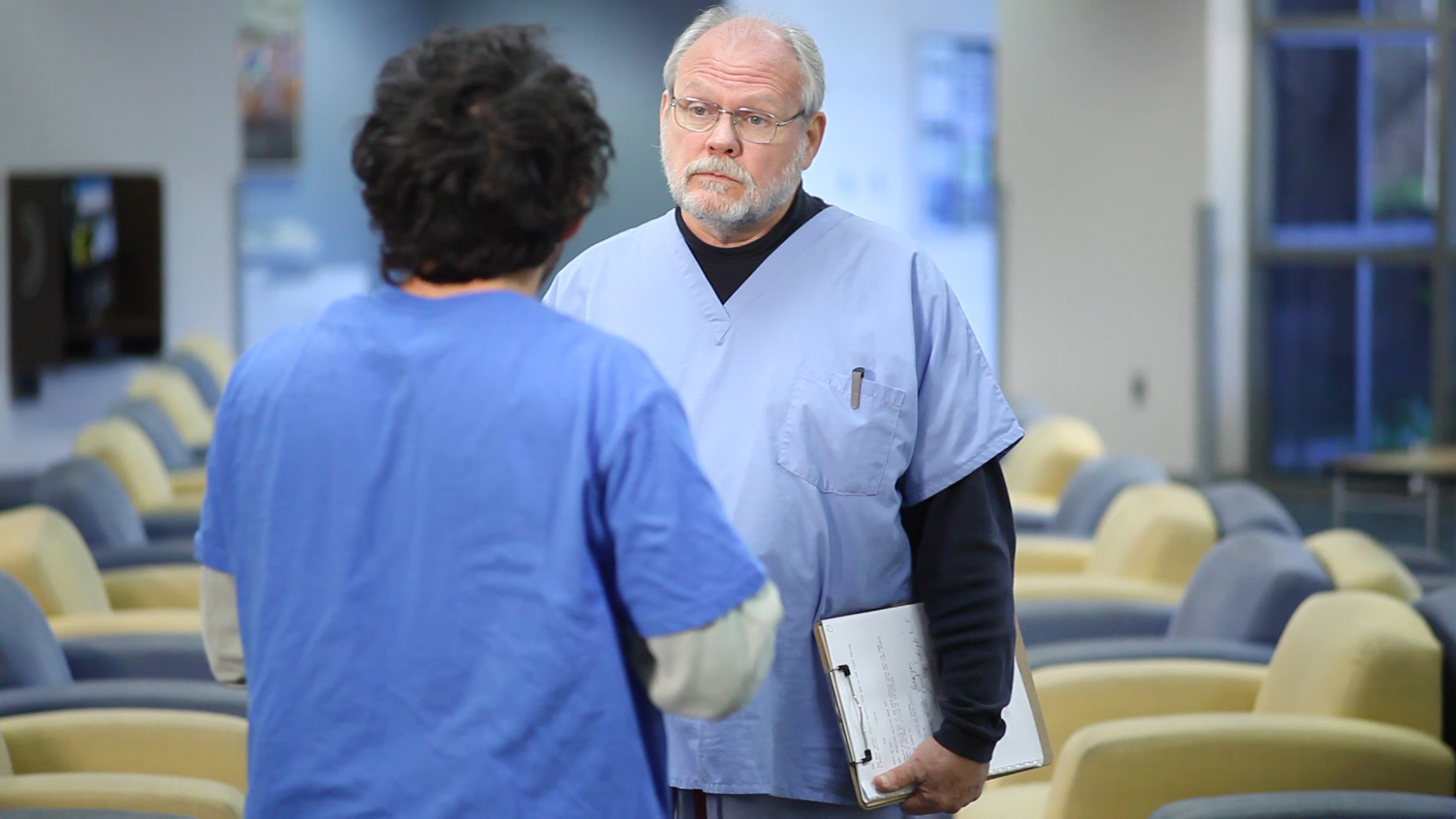

Here is an ungraded snap from one of the scenes. This is straight out of the camera, handheld shot (well shoulder mount).

Perrone,
Yes, that looks great by comparison to what i've managed to find myself. That's a really positive image and suddenly i'm interested again.
This is from a 5D?
So bearing in mind you probably have a lot of footage from this where would you say the footage doesn't work? What are the problem areas from your experience?

Originally Posted by Paul Curtis View Post
This is from a 5D?
Yes, untouched screengrab. Shoulder mount was a RedRock We were going to do it on the Fig Rig, but changed our minds at the last moment..
http://i666.photobucket.com/albums/v...Break_D197.jpg
http://i666.photobucket.com/albums/v...Break_D290.jpg
If both the camera and the subject are moving, you need to be careful. If they are moving in opposite directions, you're in trouble. The camera does not do well when it's moving quickly. Keep it on sticks, a dolly, a slider, etc., and you'll be fine.
