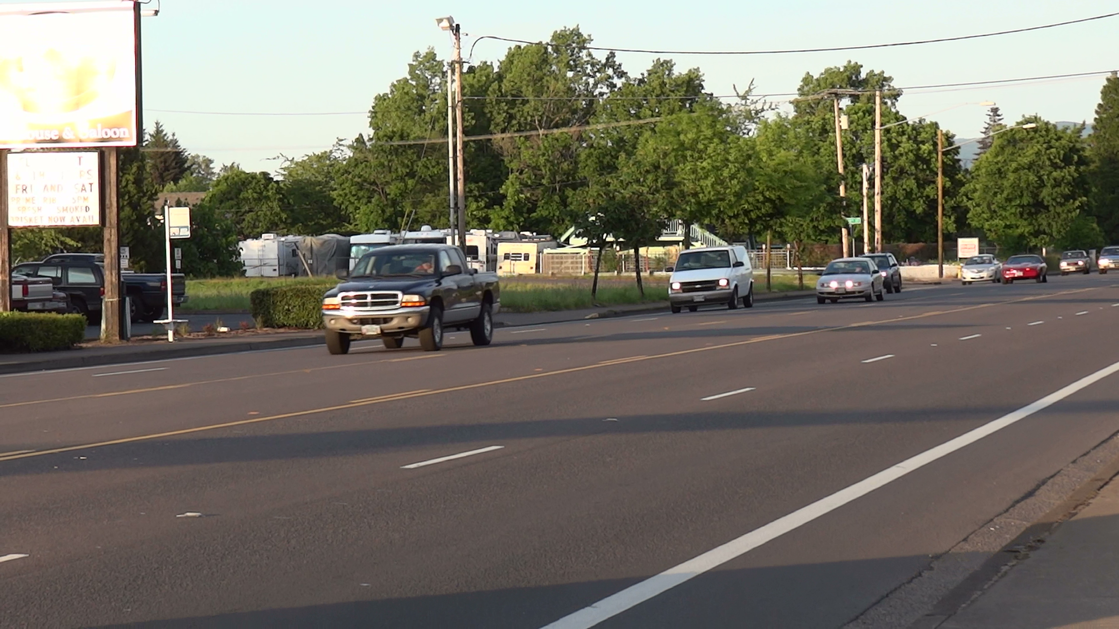

I've posted two unedited video clips for comparison on my Vimeo album, that show moving traffic. The first was shot in 1920 X 1080 60p at 28 Mbps and the second was shot in 60i at 24 Mbps, both in AVCHD. The 60p version has smooth motion with no fluttering and is more pleasant to view. After seeing this comparison, I will most often shoot in 60p.
You have to download the full uploaded files and play them on a good program with your computer, to see a fair comparison. With Vimeo's heavy compression, the 60i video looks very jerky, although the 60p version seems much smoother. The 60i video has only minor motion flaws when I play it from the full file.
I have a quad-core CPU and prefer Splash Lite for playback. I have no trouble editing the 60p video on AVS Video Editor 5.2 and rendering it into MP4 at 16 Mbps, which looks indistinguishable from the unedited camera recording.

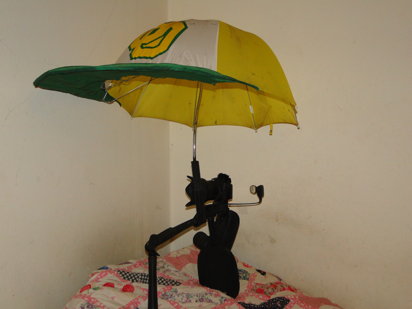

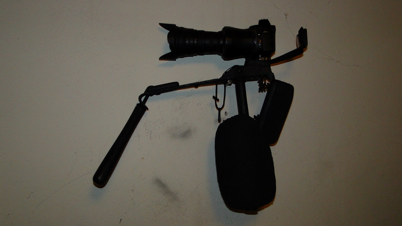

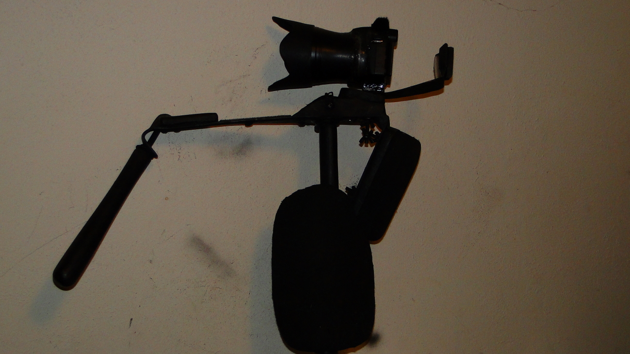

Here are three photos showing my HX100V on my shoulder mount. One of them shows my rainy weather attachment and another shows a Raynox DCR-2020PRO 2.2X telextender on a lens adaptor tube I made.

Thanks, Dave. If you liked the HX1, you'll probably be happy with an HX100V, although they have very different responses to settings. I usually lock the ISO at 100 on the HX100V and then 160 to 200 late in the evening. It shoots cleaner photos than the HX1, so I can set the NR on the Low position. It doesn't need to have the EV moved down as much as most Sony cameras and camcorders. It has an auto ND-filter mode, but most people choose to turn that off as it can interfere with the ISO and EV levels. The HD vid-caps work well on PMB. I've posted one below, from the 60p traffic video.
The playback directly on Vimeo of my 60i traffic video looks very bad, with lots of stuttering. Played on my computer with Splash Lite, there's only a few minor quivers and a small general lack of clarity on fast-moving subjects. The 60p video looks fairly smooth on Vimeo, but not as steady and sharp as it does on my computer.
