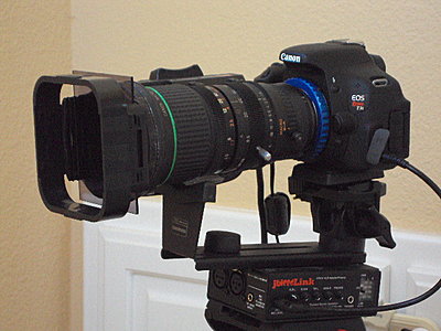

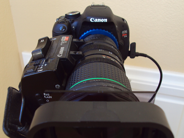

Can you post pictures of the adaptor and configuration.

Hi Jose, here you go. I'm waiting for another tripod adapter plate for better focusing but this works for now.
