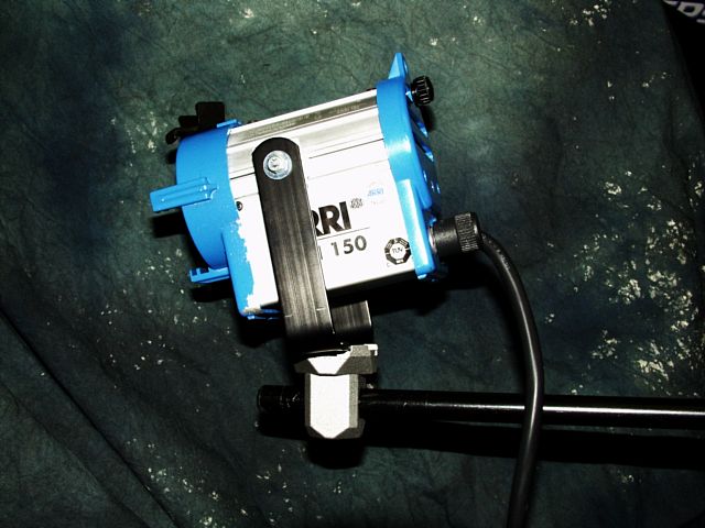

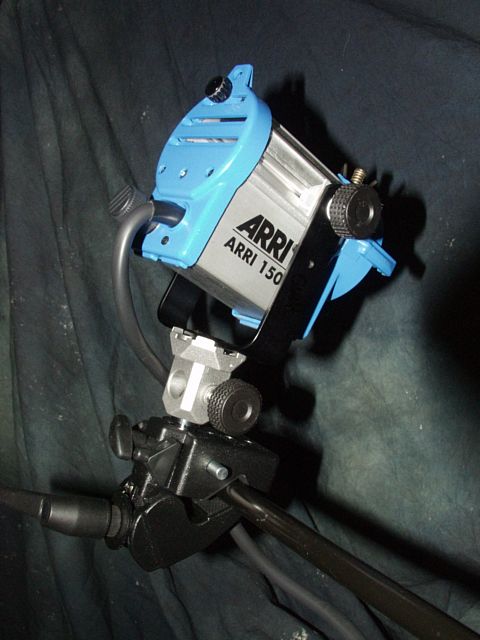

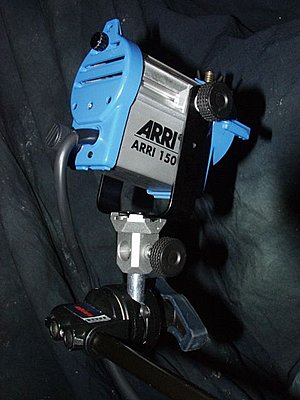

I was thinking this...
http://www.bhphotovideo.com/bnh/cont...=124751&is=REG
I added pictures of a 150 with a griphead and pin and on a mafer clamp.
Hollywood  Century C Stand Question-arri150-griphead-pin.jpg   Hollywood  Century C Stand Question-srri150-mafer.jpg
