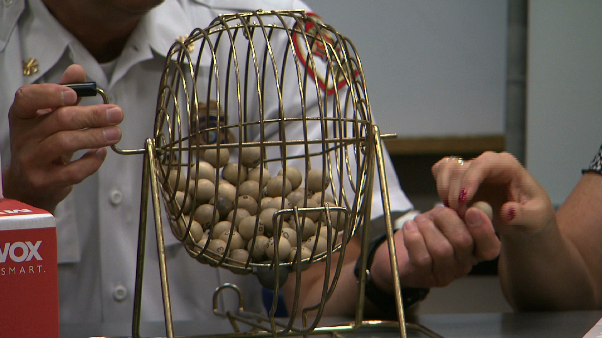

Those shooting digital (video or stills) though, which I would say is the vast majority of members here, will find their cameras are very forgiving of green spikes.
What you're saying is very true. My XD HD camera, and some others I'm sure, have various preset color matrices, one of my choices being FL for fluorescent lighting. It's a custom table that counteracts the nasty green spike. Here's a frame grab showing the FL preset in a meeting room using only standard overhead fluorescent lighting. Gamma setting =2.2.

Aren't digital cameras great? I've only shot 35mm still film in my life, never movie film, nor do I ever want to. It's just so much more convenient from so many different angles to be shooting stills or moving images via digital. The white balance aspect alone is one of the biggest features. It should be interesting to see how the RED camera handles these type issues but my guess is that it will also be forgiving.
