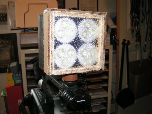

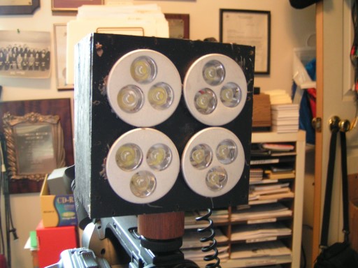

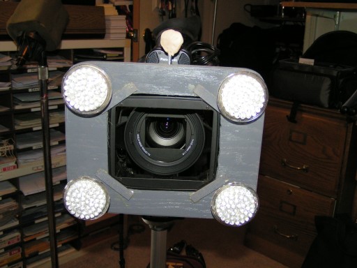

I have been frustrated too, for years I've used a lowel 100watt but is uses a lot of battery and not for very long. The commercial LED solutions didn't seem to pack the punch I was looking for, I would like distance as well as use up close. So I put together 2 versions of LED lights.
Version 1 is 4 LED bulbs that have 3-3watt cree leds. Each bulb puts out 240 lumens in a pretty focused beam. I have installed a switch to either choose 2 or 4 bulbs for intensity control. I also made a diffuser to use it closeup.
Version 2 is 4 LED bulbs with 48 leds in each designed in a "ringlight" format to eliminate shadows for closeup shots (like in the medical field) It also works very well as an on standard on-camera. Again the beam is focused and I have made diffusers for close work.
The 12 volt and only 1 amp draw allows me to run these for hours on small batteries and even use a Radio Shack converter to be used from AC.

I like your ideas, Gary. How strong does the ringlight seem? In a dim room can you shoot at under 9db of gain at about 10 feet? Are those just 12V MR16 style lamps?
Old September 30th, 2007, 08:16 AM   #11
Join Date: Jul 2005
Posts: 110
Marcus, they are MR-16 12 volt lamps. In fact all of them are. Anyhow I went back to the specs that came with some info:
There are 48 leds total in each bulb, 28 are warm and 20 are cold to create 5500 Kelvin.
Each bulb is equal to a 50 watt tungsten or so.
They have a pretty focused beam at about 20 degrees. At 10 feet they are just starting to fan out for a soft look. I use a diffuser, for anything closer, made from Home Depot diffuser material used for overhead flouresent home lights.
In a dim room I think you'd better use the diffuer.
I haven't checked out numbers, but last Thursday I shot a German Band (for a clients TV Spot) at night, in a restaurant and about 20 feet. There were 5 members in the band so I guess it was about 20 away. As soon as I turned the light on I had to white balance for daylight, so I guess that's pretty strong.
Needless to say outside it's pretty effective too.
I have to admit, though, the other light with the 3-3 watts are much more potent, on and off camera. That's why I have a switch for 2 or 4 lights. I also made a single which is great for CU and off camera. They are MR-16 12 volts also.
Gary

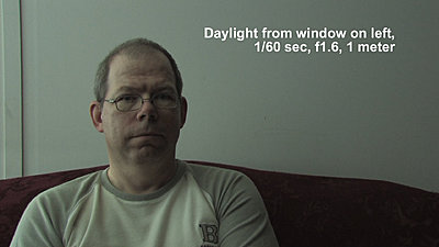

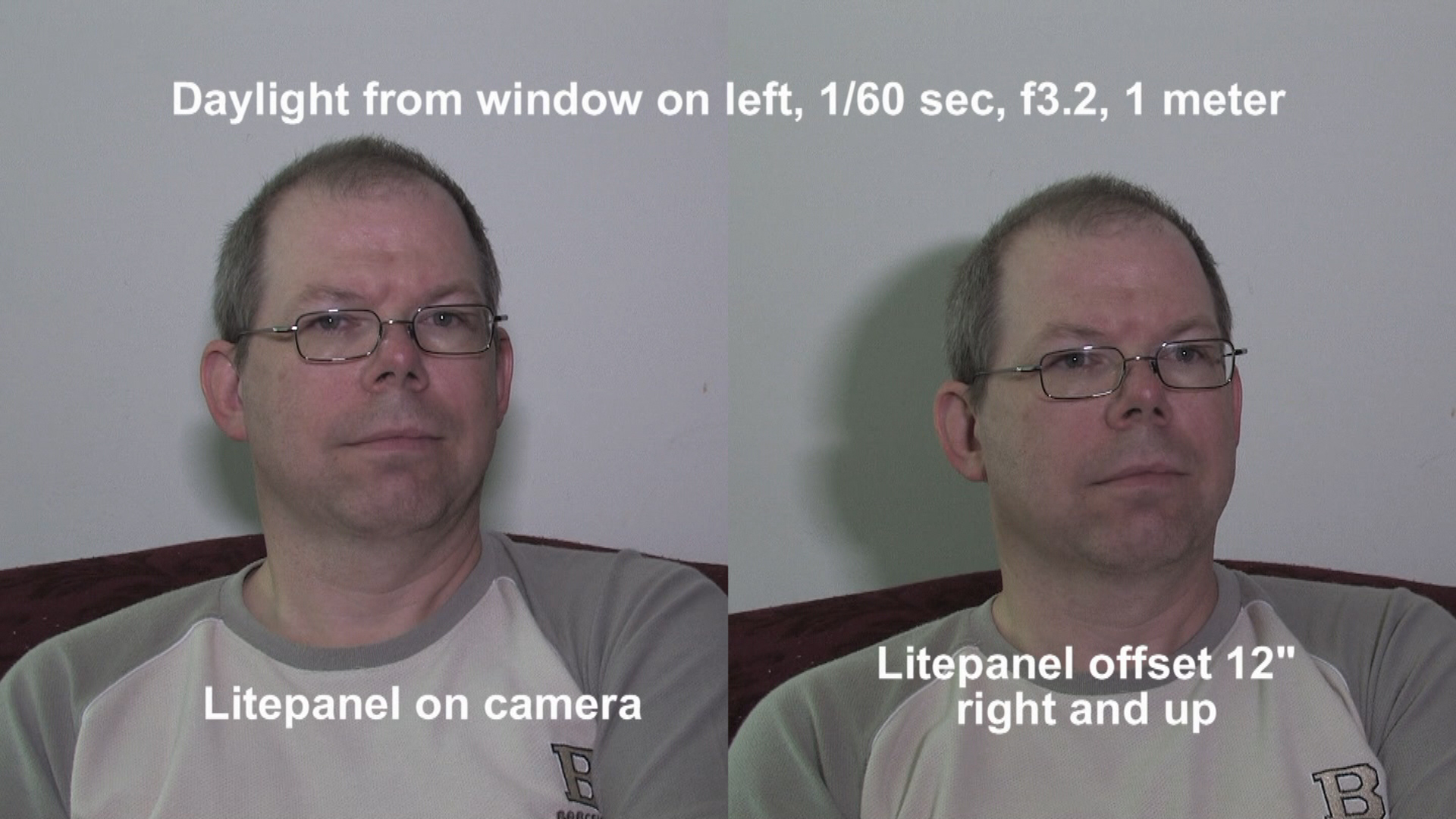

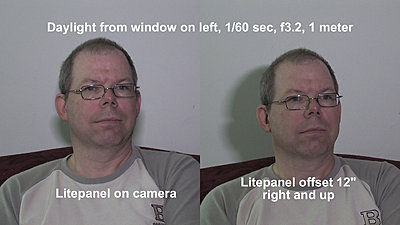

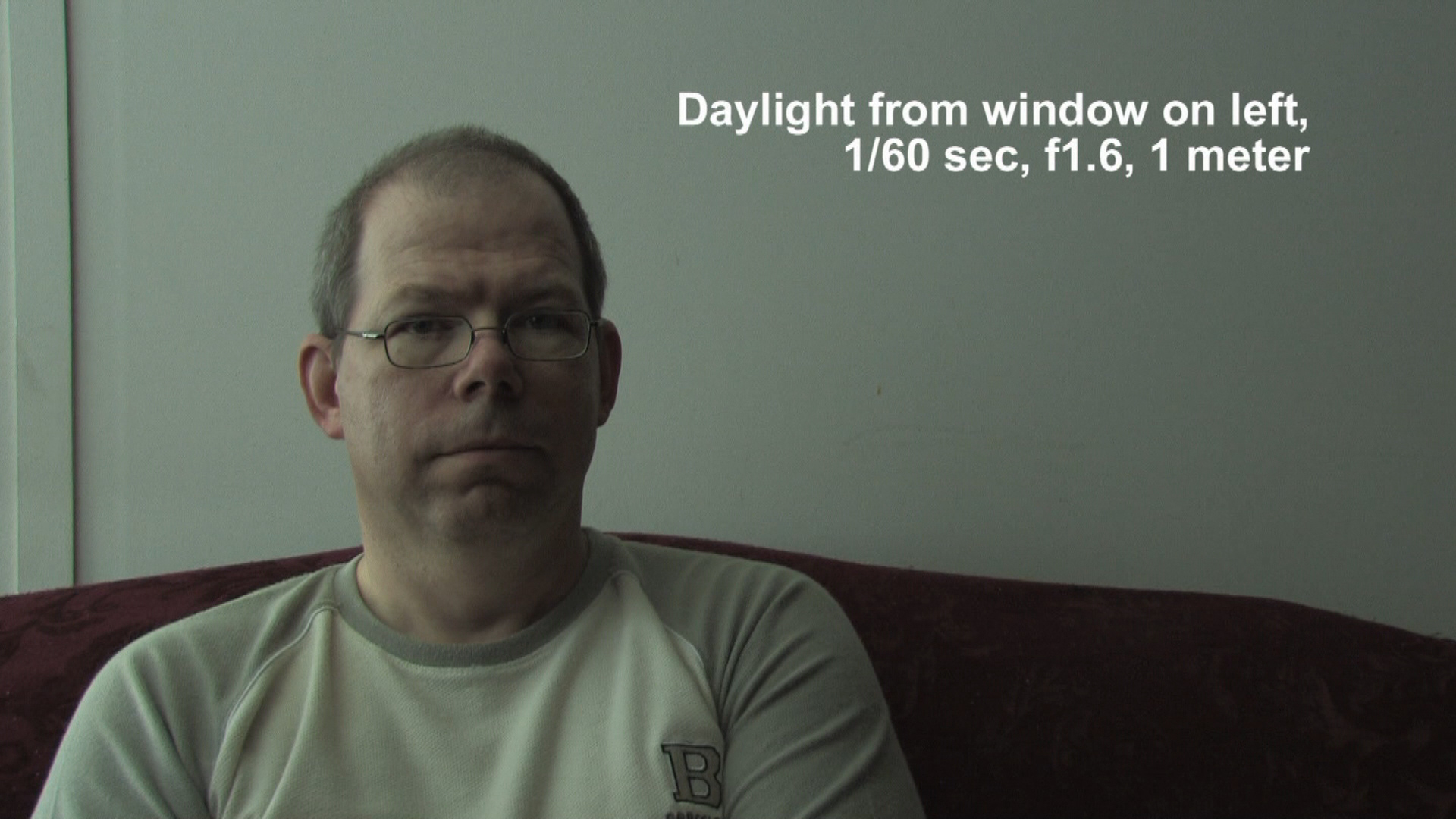

Well, I said I would post results. It also looks like I will demonstrate Dan's points as well, although it would take a lot more than lighting to make this talent look great (and less scary). ;-)
These are frame grabs from my Canon XHA1. The on-camera light panel was mounted with the supplied hot shoe mount. The offset litepanel was mounted on a DVMultiRig using an 8" Noga arm. It doesn't make enough difference to bother with the setup effort. It also throws the DVMR way out of balance.
Note: The wall is only 6" behind the subject. You wouldn't do this in real life.

The offset mostly just eliminates a couple of highlights. The increased exposure is impressive using the light, but the offset doesn't make a significant difference in the quality. The quality of the light from the window alone is mostly better but the exposure is insufficient. Maybe the litepanel offset on the fill side and dimmed down would look nice in this shot but I don't think there is enough light from the window to act as key.
I'm assuming this is not one of the 1'x1' litepanels but rather their mini camera light. Since there seems to be plenty of exposure, perhaps it is strong enough to work with one of those inflatable softboxes used by photographers. Since it isn't going to get hot, it won't melt plastic. One of those lights with an inflatable softbox would be small and light but might look nice. As it is, it is bright and probably lasts forever on a battery charge.
Glen, can you say whether or not the light is less unpleasant to the subject? If the offset helps get a better reaction from the subject, it might still be worthwhile.

I agree with you, Marcus. The window will not work as key. The unlit sample was shot to provide a baseline showing the existing light. It is fairly accurate since neither the wall or my shirt is white. The camera was WB'd with a sheet of paper.
My appologies for not mentioning the LP model. It *is* the MiniPlus system 5600K flood at 100%. No filters were used. The A1 was running on factory default settings (read: flat).
I'm not sure what benefit would be gleaned from a softbox other than widen the coverage slightly. The light alone is quite soft and the dimmer can drop the intensity.
I have been subjected to many wedding "table shots". I found the LP to be easier on the eyes at 5600K and much easier on the eyes using the 3200K filter. The best part is they don't throw the heat. It's already hot enough in a tux.
