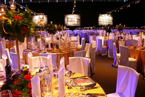

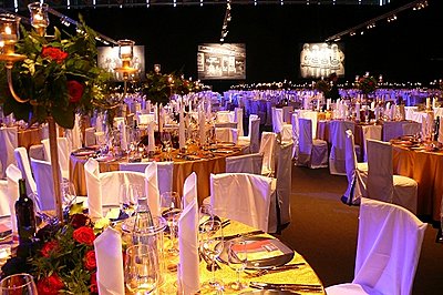

The best solution I have ever seen to light an audience was at a big gala dinner this year (many round tables for 8 people each, stage in front). The production company had set up dozens and dozens of par64 cans on the ceiling which lit the tables from a steep angle so no one was blinded. It looked like a candlelight dinner (in the picture I attached it looks a bit brighter than it did to the naked eye) but it was perfect to shoot at f2.8 without gain.
You can see the truss with all the silver Par64 on the ceiling in the background, I imagine this setup wasn't cheap.

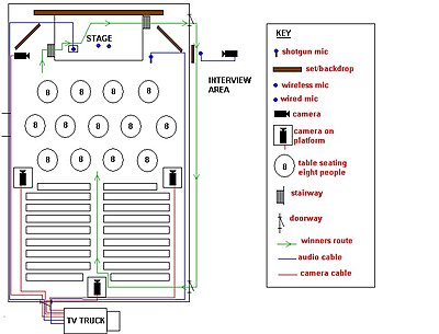

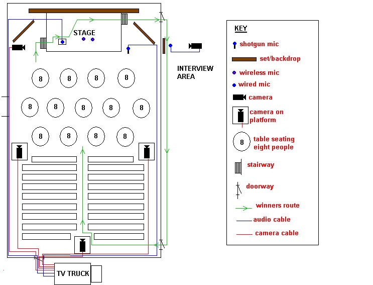

To add a bit more info, we've got a very basic layout drawing to give you an idea of the set-up we're going for. Also we found out that we have access to a balcony area above the entire gym to use however we need. The set design is basically some flats decorated to look like store-fronts. We're planning on a long set accross the front of the stage facing the audience, which will house the projector screen, and then some angled set backdrops on either side. The house lights will most likely be off, and sorry if it wasn't clear in the first post I'll be the one in charge of the entire thing, so nothing is set in stone at all.
Thanks again,
Nate

"Also we found out that we have access to a balcony area above the entire gym to use however we need."
My guess is that unless you want a big truss over the stage you will be taking advantage of the balcony. Make sure to clamp AND use safety cables on any lights up high.
I imagine the setup Heiko showed is way out of your budget, but there seems to be an important point in there. Keep the lights up high so as to not blind the audience. You probably can count on reflection coming up from the tables to help fill the audience a bit if you have pars aimed down at them from up high.
Have you scouted the location to see what electrical service is available? It looks like you need a lot of juice.
Can you include a drawing of the balcony?
I'm guessing, for cost purposes, that a big cluster of lights above (maybe a bit in front of) the camera on the right is the best place to put the key, especially if the balcony is over that area. A smaller cluster on the left above that camera can fill that side and the middle cam should have plenty of light.
I like that idea of putting lights up high behind the stage, but is that in your budget? If not, maybe one big one behind and to the left to act as fill for that camera over there would also give a tiny bit of accent/rim light for the stage. If the balcony is above your side cameras, that will save the cost of renting a big truss and all you would need to put on a stand would be a par or open face behind and left of the stage.
I don't know how much it costs to rent equipment in your area, but a 1K fresnel and a stand are about $40 here. That would get you about ten lights which sounds about like what Heiko says you need for the stage if you don't put many in the back. The last $100 isn't much for audience lights, but you can get stands that each hold a few lights so you could save a few dollars by not renting one for each stage light. Hopefully, you have a stage lighting company that is cheaper than the film rental company here.
Have you called the lighting companies in your area to see what is available and for what cost? They might also hire lighting guys and they could help you match your location/budget with the available equipment.
