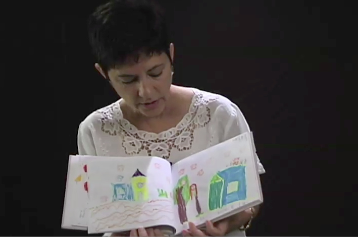

I don't think there's anything unique about the setup you describe. Adapt standard 3-point lighting principles to the situation. Hair/Back/Kicker lights are critical for separating your subjects from the background. If the subject is bald, use barn doors so the light stops before it gets to the top of his head but still lights shoulders.
I think a big annoyance to viewers will be reflections from the wheelchair or glasses. An approach I thought of when reading your post was to use a black void setup. That is, the background and floor is black and you light up the subject however you want (see attached). This setup was based on a collapsible 8'x8' backdrop by Botero with an 8' train for the floor. The nice thing about it is that you don't get shadows on the black which means you can put lights in places that you normally wouldn't.
I've recently developed an appreciation for what many refer to as "painting with light" where you control spill and put light only where you want it. I quickly run out of small under 100w lights but the results are spectacular.

I like the idea of a black background and I'll run it by my friends amd see how it goes. Both my friends wear glasses, but the wheelchair is a sort of matte black so it shouldn't cause too many reflection issues - might even sort of disappear against a bleack backgrounfd
