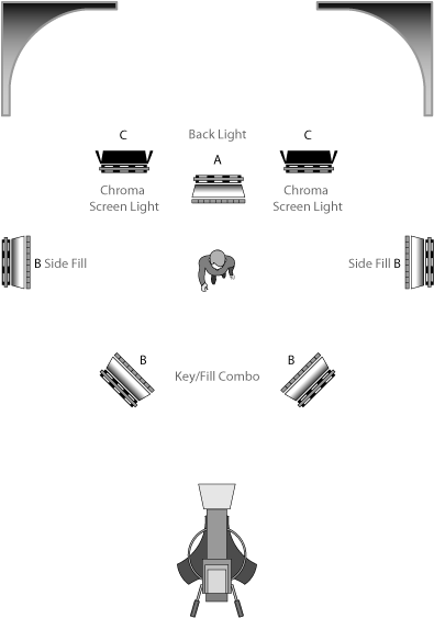

The Lowel DVcreator Kit 55 would work if you added another Reflector and another umbrella for Omni.
Rifa 55 Key on Talent
Reflector Bounce for fill on Talent
Omni with Umbrella Chroma Screen Light Left
Tota with Umbrella Chroma Screen Light Right
Pro light for backlight
Here is a general diagram http://lowel.com/fluotec/setups/chromaset.html
Watch the little video "lighting greenscreen" at http://dvcreators.net/dv-enlightenment

I would agree with the coollights idea. For such a small space, fluorescents will be cooler and are softer, especially important for the flat lighting you need for green screen work. For talent, one small light for a backlight, and either a fluorescent or a fresnel with difussion for the keylight. You could use a white foamcore sheet for bounce on the opposite side if you are running low on your budget.
The diagram that was posted could easily work without the side fills, if you adjust the key and fill positions right.
With greenscreen, the light has to be flat to pull an even key, and if you can, seperate the desk and talent as much as possible from the backround to keep the green from 'spilling' onto the talent. That's, in part, where the backlight can be helpful.
Don't forget mounting hardware-you can get stands, or if you can mount to your ceiling, plates with posts. If you are on stands, your backlight might need a boom arm.

The fluos are 6-bank Mistral (dimmable) with additional Leelux 400 white diffusion. The key is very flat, max. 10° to the right (if at all) and very low, just above the camera. The fill is from the left with a much higher angle (80° I guess) and a lot higher. Because the key light is so flat, I added a piece of white foamcore reflector for fill to the right side as well.
I also used a 6-bank fluo with WD for hair/edge light (not the best solution for an edge-light , but very good for eliminating shadows on the bluebox floor).
I installed a flood-light (1000W Tungsten) to light the blue backdrop, but amazingly the keying worked just fine even without that. The background was already lit pretty well from the soft spill... I installed the background-light anyways to be on the safe side in case somebody is wearing very dark clothes.
The setup is very similar to the diagram above, only I'm using just one keylight, almost directly above the camera. You can't do that with a fresnel, it will blind everyone, but it works perfectly with a large soft source like the 6-bank fluo with WD
