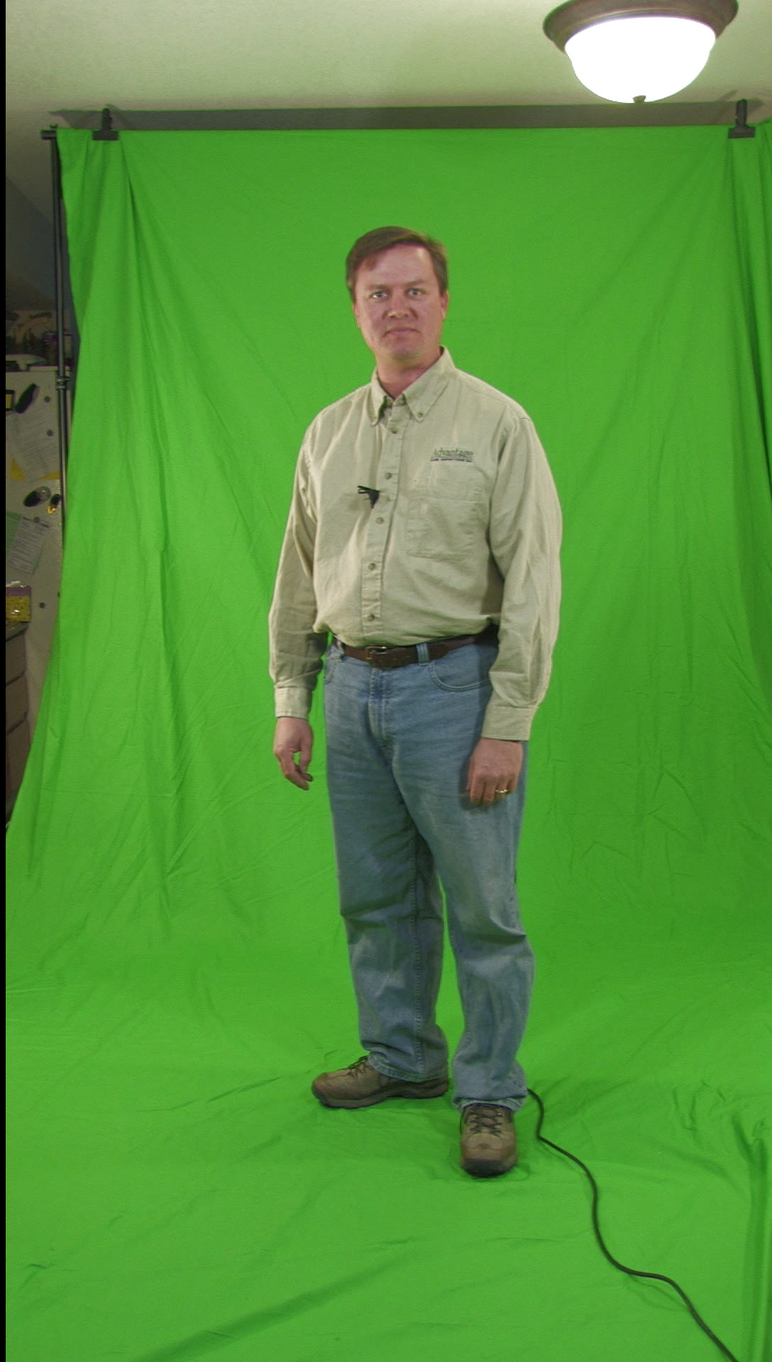

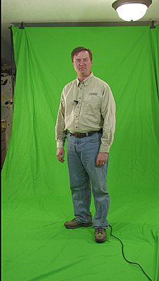

I bought a 10'x20' muslin chromakey green and 13'-long support system on eBay and use is to pull some pretty good keys with Adobe After Effect's Keylight keyer. I've shot in my home in various spaces in the local area as small as 14'x10', but the setup works best in 20'x15' rooms or bigger. I can set up the screen, lights, camera and audio in about an hour.
I've done one head-to-toe job where I keyed out a buddy of mine for a "walk-on" website. The final results are on the first four pages of this site here: http://www.inspectionadvantage.com/ I'm also attaching a frame grab prior to keying.
Due to the final image size and zero budget, I didn't spend much time lighting the talent or the screen. Used a total of five lights: key, fill, hair, and two screen lights. All compact flos in inexpensive SmithVictor lights and stands. I also rotated my XH-A1 90 degrees with a home-made bracket.

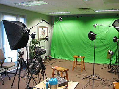

Originally Posted by Lloyd Claycomb View Post
Thanks for that. I'd love to see a wide-angle of that shot to see the lighting placement. Do you happen to have something like that?
Lloyd, this is from a different shoot, and there's some extraneous stuff in the shot since I was sharing the room with a still photographer, but you'll get the idea... screen lights, key, fill, and hairlights.
One of the interviews that day was of four co-owners of a local business, and that was a lot of bodies in one place at one time. We shot it with two cameras, four lavs. and a couple more lights. It was far from perfect... lighting or audio-wise, but acceptable in the end. I'm still working through the edit and keying, so I'll have to see what I can do with the footage.
