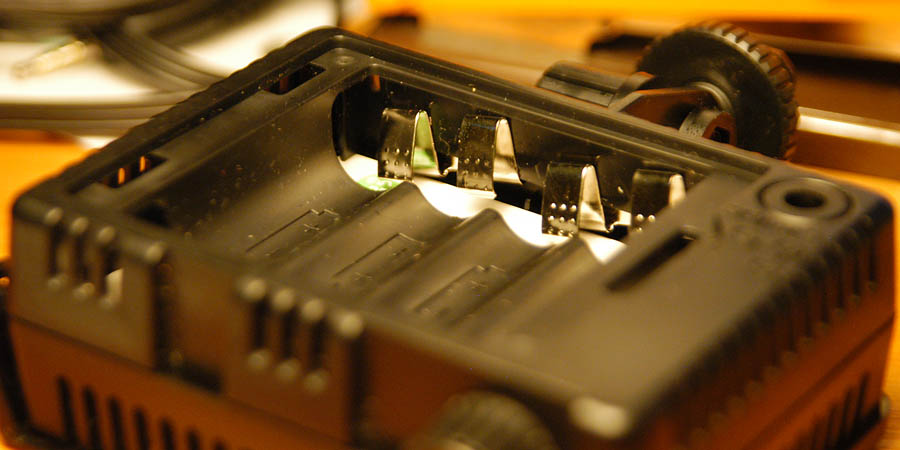

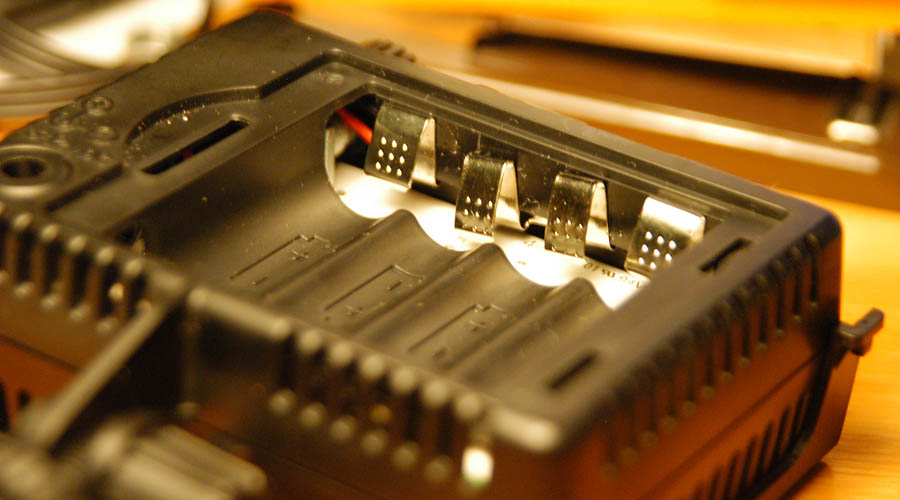

I received my LP-Micro today and I am disappointed in the quality. The battery contacts were not aligned when I opened the compartment and when I tried to load the batteries, the contacts slid down even more. The result is the batteries try to pop out or don't make contact. (see photos)
I would align and glue the contacts to solve the problem but I am afraid it will void the warranty.
Also, another post on this list said that rechargeable batteries won't work in the unit but the instruction sheet included in the package says "Rechargeable AA and Lithium Ion batteries can be used as well."
Steve

First I too had 1 battery clip slightly out of alignment but luckily doesn't affect the battery staying in place.

I checked the battery clips today and found that if you take a neddle nose pliers and carefully pull the contacts all the way back the batteries clip in the way they are supposed to. The contacts simply slip into place over an edge of the battery compartment.
While I am a bit disappointed with the overall construction, for the money and weight savings, it is an excellent light.

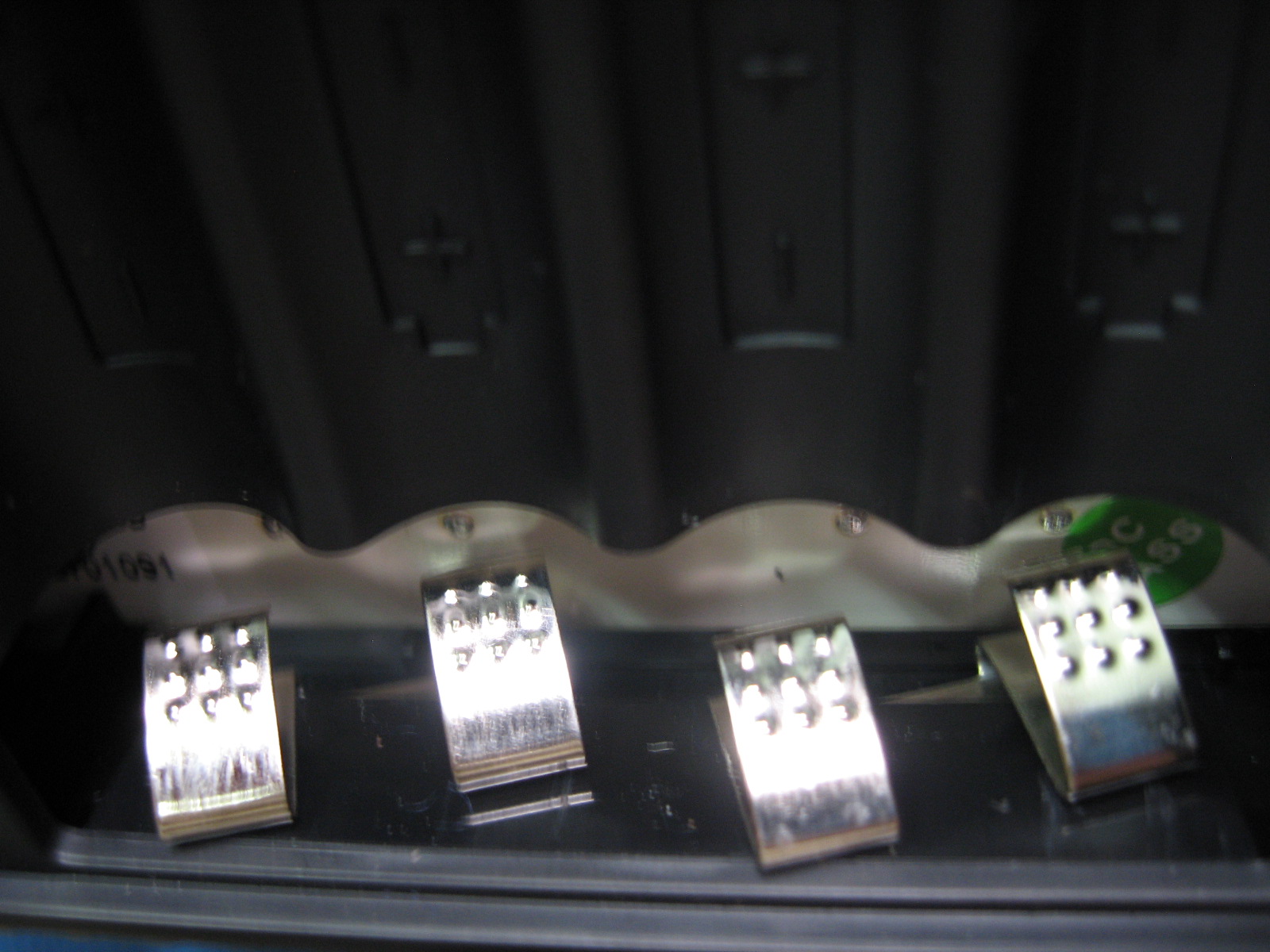

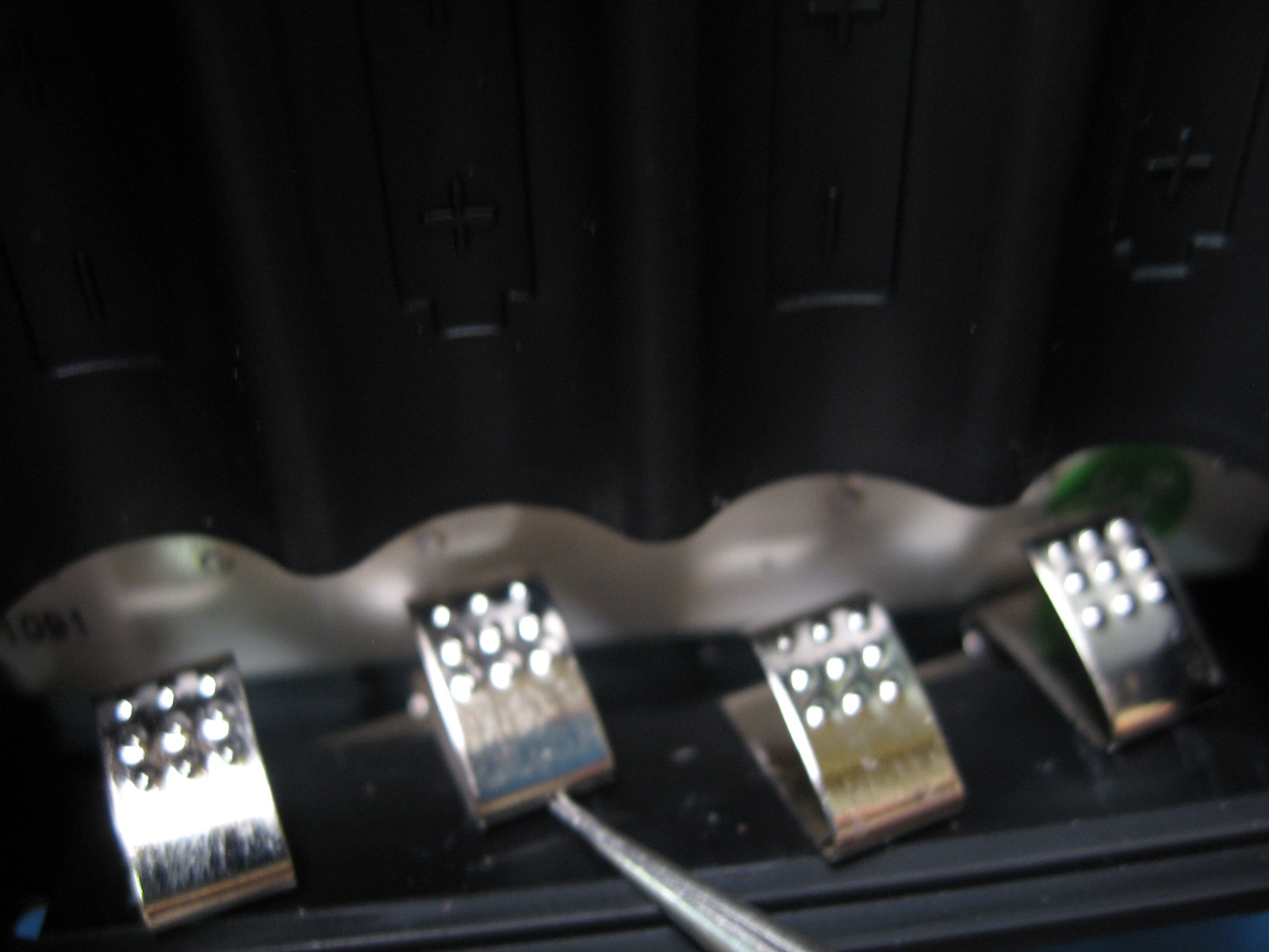

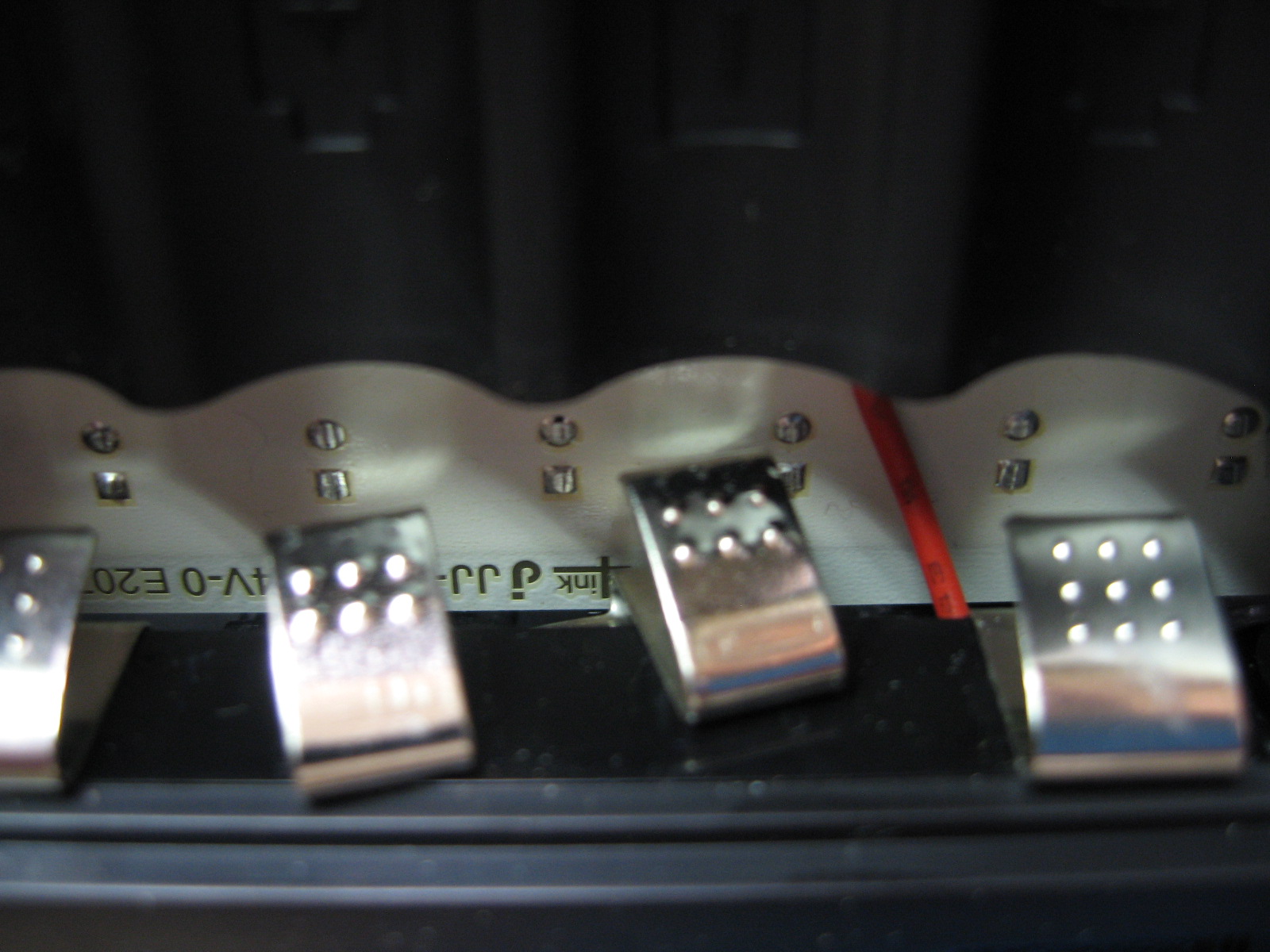

Being one of the early beta testers of the Litepanels Micro, I was not able to find this fault of the unit. Even with repeated loading and unloading of the batteries. However, like quite a few people, I usually place batteries in at an angle then slide them in. For those that just plop batteries in straight down it will eventually push the clips out of position (not good). I wish we would have caught this earlier, however this is the first production run and all future models leaving the factory are being corrected.
From Litepanels:
"We have had several complaints in regard to the Micro battery terminals moving out of position when the 4AA cells are inserted. You may experience this problem if your shipment was included in the first production run of Micros numbered 00210 – 00799.
We have addressed this issue as follows:
1. Remove Micro back panel
2. Push back the right side of each dual battery terminal as shown in the attached images 016 – 017
3. Apply a very small drop of “Super Glue” to each of these battery terminals
Do not allow glue to “run” down onto PCB or the outside of the Micro housing.
4. Reposition the battery terminals immediately and allow glue to set in dry along the front of terminal
5. It takes about a minute for the glue to set up and it is fully cured in 30 minutes.
Litepanels will perform this task for all outgoing shipments and we are in the process of upgrading this part of the housing to better accommodate the battery terminals."
